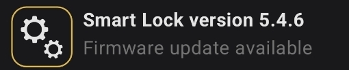

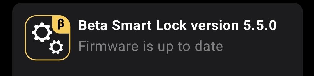

three times tried to install, not possible. Ultra don’t load the firmware.
For me only this firmware available not bèta 5.5.x
After first update latest stable firmware, latest beta available…
