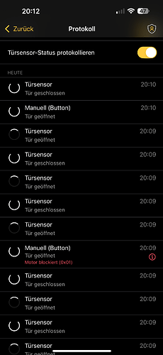

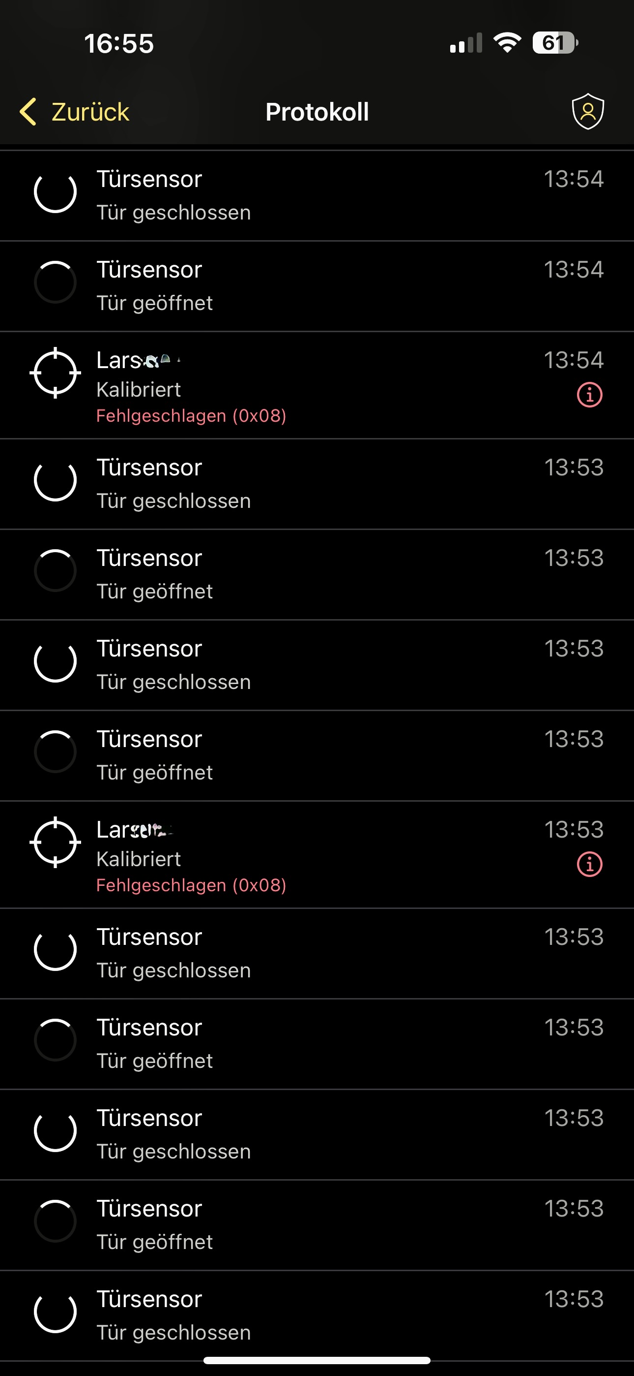

See the screenshots from the last two days with the lock in action. I would say that every 4th or 5th attempt to open ends with a blocked motor. Sometimes the blocking doesn’t stop, even after manually pressing the button. Once, I tried to start calibration directly from such a blocked situation and was worried whether I would be able to use the lock again, since it remained in the “not calibrated” status without releasing the motor. Somehow, however, I managed to get it working again.
