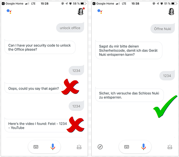

At the moment it seems like the problem only occurs for other languages than German (e.g. Dutch, English, …) and mainly for iOS users in combination with Google Home.
Unlocking works fine in German (also German on iOS) and also for most Android users. Strange thing is, the code is the exact same for all languages, so we think it might be a problem on Google’s side.
Example conversation in English (fail) compared to German (success), using an iOS device:
We are already in contact with the Google support. We let you know when we come up with a solution!

I found out what was causing my issue with unlocking the door with the PIN. I had a PIN with the number 2 in it, and when i would say my PIN 1234, I noticed the assistance picked it up as 1 to 3 instead of 1234, so it would say sorry can’t help with that.

I have the same problem. I found out that if you speak out the full code as one number, Google Home understands it. If you say it per digit, it doesn’t work. Example: 1234 would be ‘twelvehundredthirtyfour’ instead of ‘1, 2, 3, 4’.

Problem solved…1234 does not work, using another code will work.
