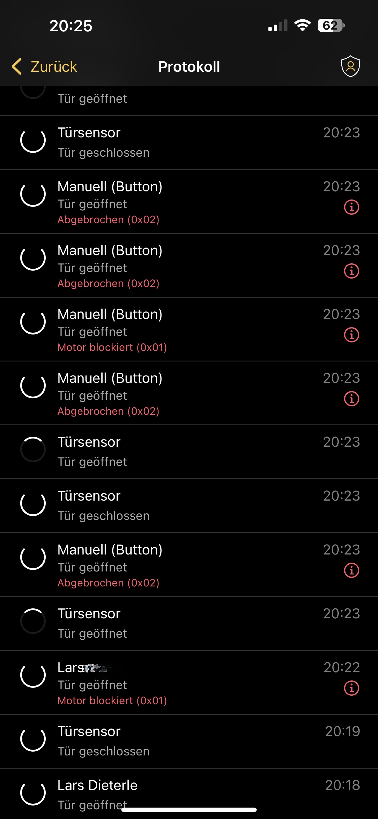

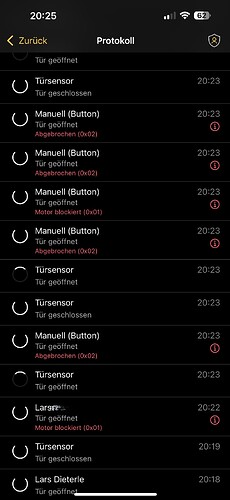

As seen from the attached screenshot, motor blocking is unfortunately still happening. As suspected, it doesn’t seem to be related to whether Matter is active or not. Now the ball is in Nuki’s court to tell us more. I am a Test Manager — please feel free to contact me if you need a professional testing setup in your company. :blush:

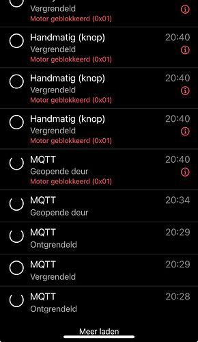

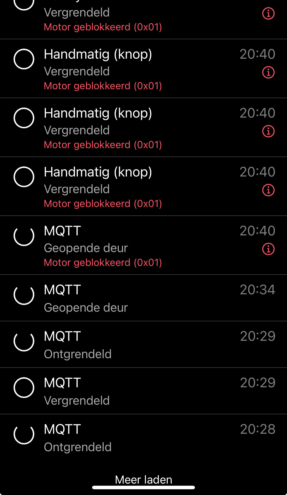

After half a day testing another motorblok (unlatched holding)
So Matter or Mqtt with firmware 5.4.6 is still a problem.
