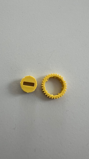

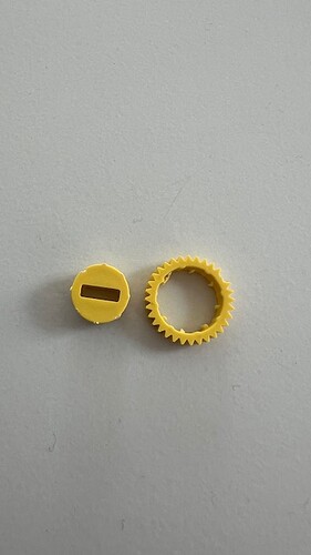

I’m now part of the statistics… the yellow gear broke into 2 parts after the Nuki Ultra tried to open the latch endlessly while grinding it…
What can we do here? It’s my 3rd Nuki and the first one that makes so many problems.
This is unacceptable and starting to look like a bad joke!

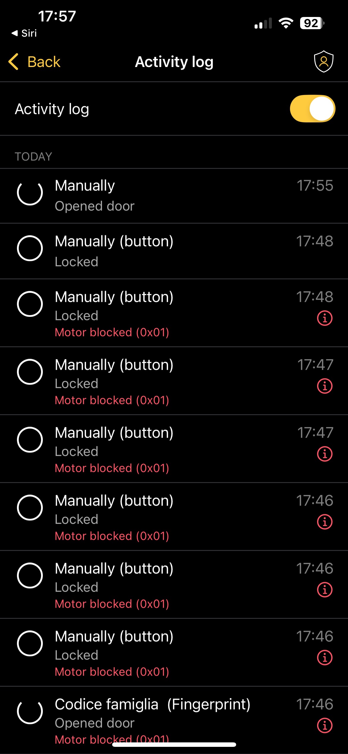

Just updated from the public release to the beta, can confirm the motor blocked issues aswell. every 3rd-ish attempt it just blocks and wont unlatch. I have to manually release the lock from the door to make it stop. Very annoying.
Since 5.5.5 update when i unlatch lock, it unlatches, but imediatelly it locks the lock so i have tu unlock it manually to close door, recalibration done twice…
https://youtube.com/shorts/lMJeMuSRRp0?si=tG2T-tW3WpmLz11t
I hope for a fix as soon as possibile, today my wife spent about 2 minutes in front of the door with motor blocked…I’m near to launch the key through the window, it drive me crazy. If problem persist I will return the product. My door is mechanical perfect and I’m using your NUKI cylinder…so c’mon devs…
ps: I think that this issue is related to a motor failure…strange sounds become from the key if I try to press the button tu unlock and after successfully unlocked if you rotate manually the key some “noises” come from the knob…

  • You were on the inside and pressed the button on the lock (thats whats in the log) and i suspect that the lock did not move. When turning the lock manually by hand, was the mechanism blocked (i.e. the clutch of the lock engaged)? Did you try manual turning in both directions?
I suggested to my wife to try to click the button (previously happened to me and seems the button solved the problem but not 100% sure) but she said to me that every time she was clicking the button she heard a little movement similar to: zzz…zzz…zzzz…seems the motor try to rotate itself back and forth without success. The manual rotation of the Knob is impossibile because the motor is more powerful of her hand and was blocked. I suggested to my wife do not put strength to manual rotate the knob to avoid to damage the internal plastic gear.
  • How was the situation finally resolved?
who knows? after 2 minutes the key released the door latch…she tried to click the button but didn’t works and at the end I tried to open via app and the latch has been released…coincidence? who knows
