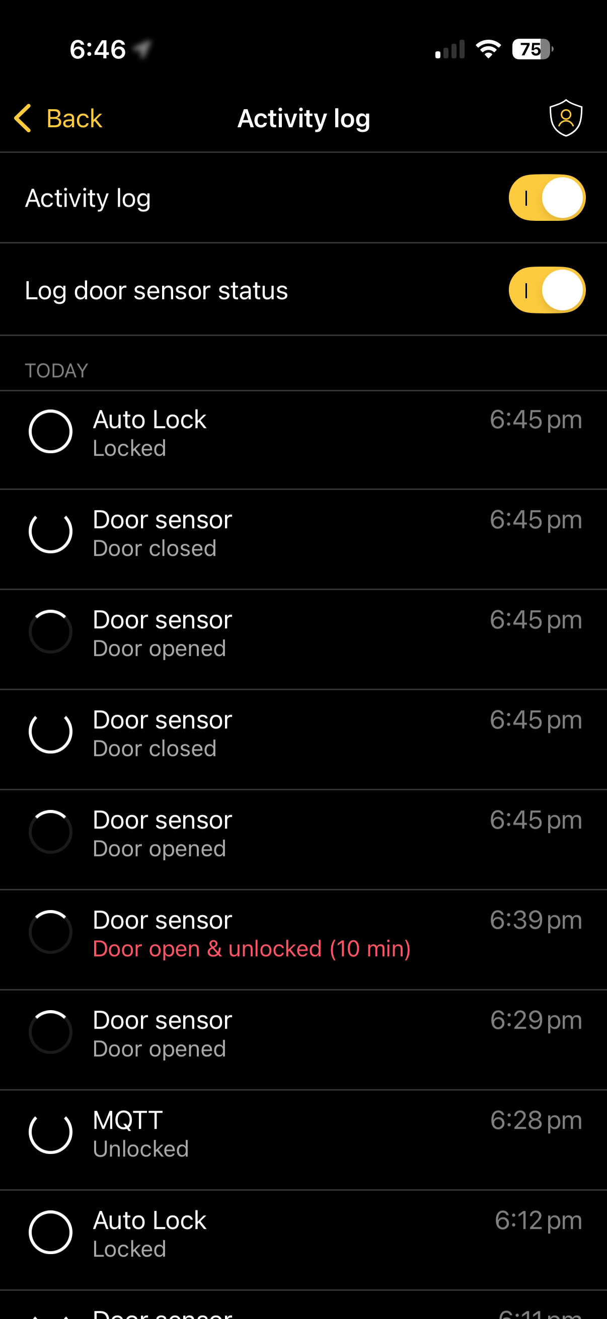

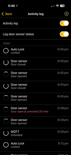

I still haven’t recalibrated the lock yet, but I had the same issue again tonight as last night - door didn’t lock.
Here is the log from the app. The door was open less than 1 minute but as you can see it reported differently. Battery still shows Good. Firmware is 1.20

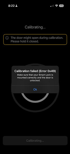

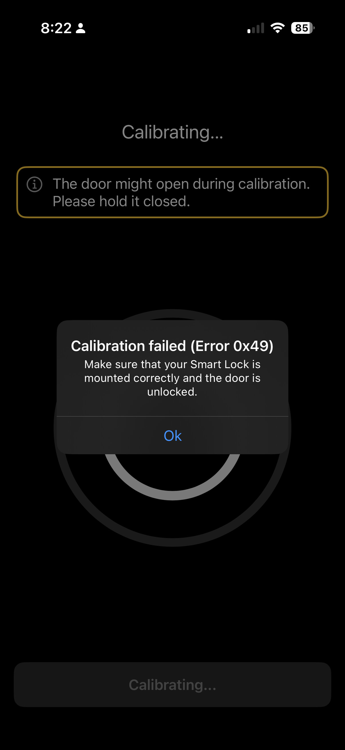

I seem to have a problem recalibrating. I have followed the onscreen instructions but I keep getting the same error code 0x49 see attached. I have tried new batteries and get the same - the mechanism just will not turn and flashes red light. I have left the battery pack out for 20 minutes and still get the same when trying to calibrate. I am now stuck with a dead lock
I think I may have resolved the issue. Yet another brand new set of batteries (Amazon Basixa) and the lock did its calibration. The first set of brand new batteries were Varta Energy
