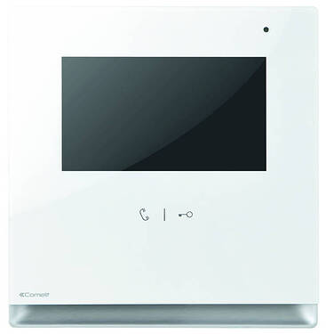

I have Comelit 6601W. In the next days I will check the signals with an oscilloscope. This should be helpful for Nuki teamā¦

The comelit bus system is encrypted so the packets on the bus are different from each other. Therefore you are able to complete the configuration process for the Opener but after that it still doesnāt work.
If there will be a cooperation between Comelit and Nuki in the future, you will need an on-site technician to bind the Nuki Opener to the Comelit system. The question is who pays for that and will your property management accept this?!
Alternatively you can connect the Opener in an analogue way like itās already done for SKS systems thats bus system is also encrypted.
Therefore you need to connect the Opener directly to the contacts of the loudspeaker and the unlock button.
In my case the Comelit 6601W has only touch buttons and Iām no professional electrician who can either identify the responsible contacts or soldering on the PCB.
So for me there is no solution for now and Iāve returned my Nuki Opener.
Maybe in the future there will be an adaptor to connect the Opener. Until that Iāll need to double unlock my electrical locked house entrance door in the old way with the key ![]()
My Comelit 6601W with touch buttons:
Thanks, @paddy2202! Itās not only bad news, but I guess I will not go down that routeā¦
