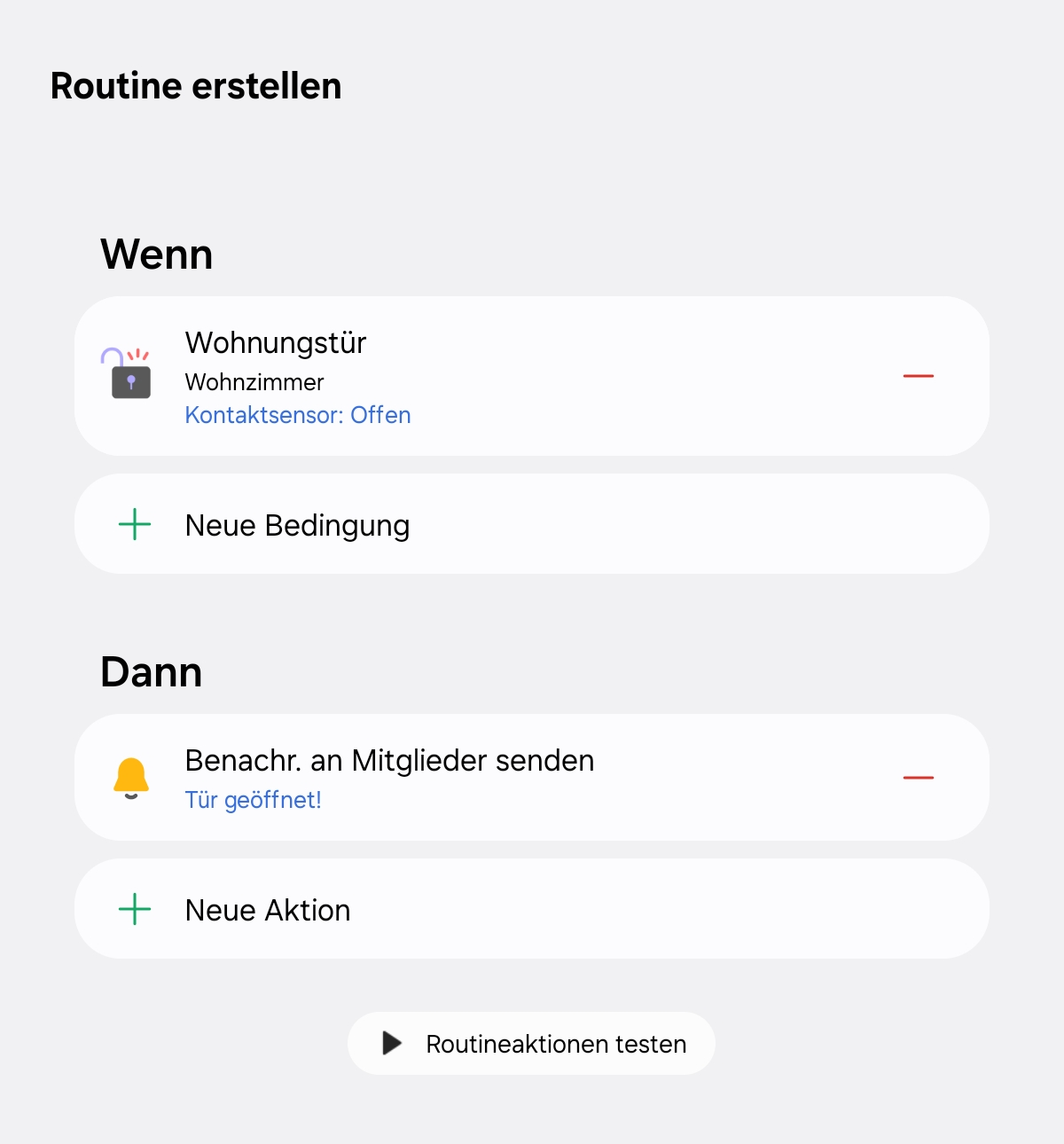

Since a few months now, the door state is exposed via Matter:
The current SmartThings Matter Lock driver doesn’t support this feature. Therefore, I developed a Matter door lock driver that supports door status. It appears as a standard door contact sensor and therefore currently only supports open and closed. Everything else than closed (ajar, jammed, …) is considered as open.
You can install the driver from the link in the following post:
