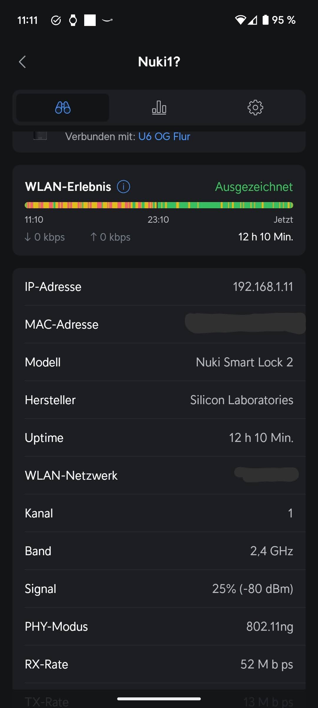

The App says that there is no server Connection but WLAN is there. My Unifi App also confirms a Connection. Interesting is, that the Connection Qualtity is quite low. The Weeks before I had a good quality. At this place my WLAN is normally good and stable. The AP is not far away! My other lock ist working without any trouble.

picture 1/3
picture 2/3

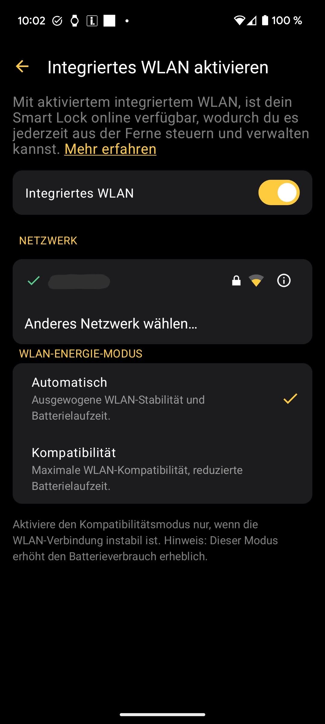

and now without bluetooth
now edited without personal Data

Looks like the Smart Lock has problems to keep a stable WIFI connection. Here is an FAQ with steps you can try: Smart Lock WiFi/Thread/MQTT connection troubleshooting / FAQ - #8 by Stefan_Reiterer
There were also some suggested settings for Unifi APs here in the forum. Search should help.
If the Smart Lock connects to the wrong AP, creating a separate network just for the Smart Lock on the AP you want it to connect to, might also be worth a try.
Finally you could also try the latest Smart Lock Beta and test if it makes a difference.
