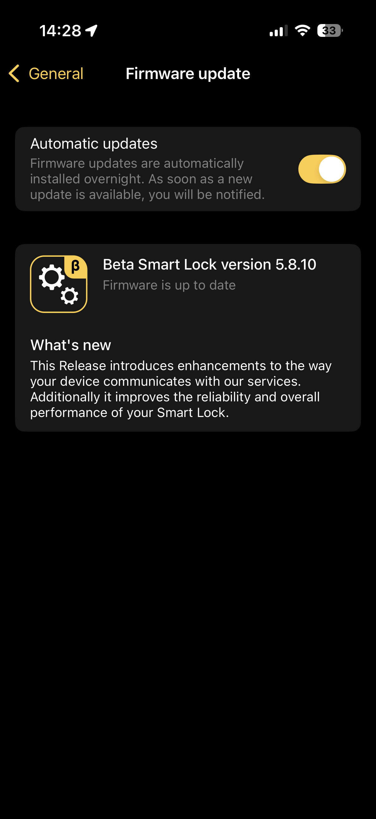

I’m not part of the beta programme but the app is saying that my Ultra is running the beta of 5.8.10.
I’m using the iOS app version 2026.7.1

The switch to the new infrastructure is part of the 5.8.10 public rollout, which is currently being deployed in stages. While this process is underway, you might notice the release labeled as “beta” in your app. Rest assured, you are running the official public version, and the “beta” tag next to the release notes will disappear shortly.
