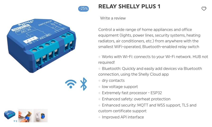

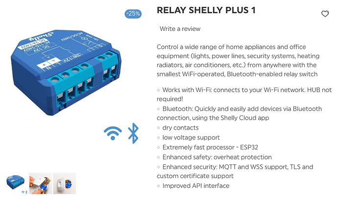

Hello,
Thanks a lot for your comments. I just moved to a new apartment am into the same issue with my T-740.
When it is mentioned “Shellyplus1” it means the one on the picture below ?
Thanks
