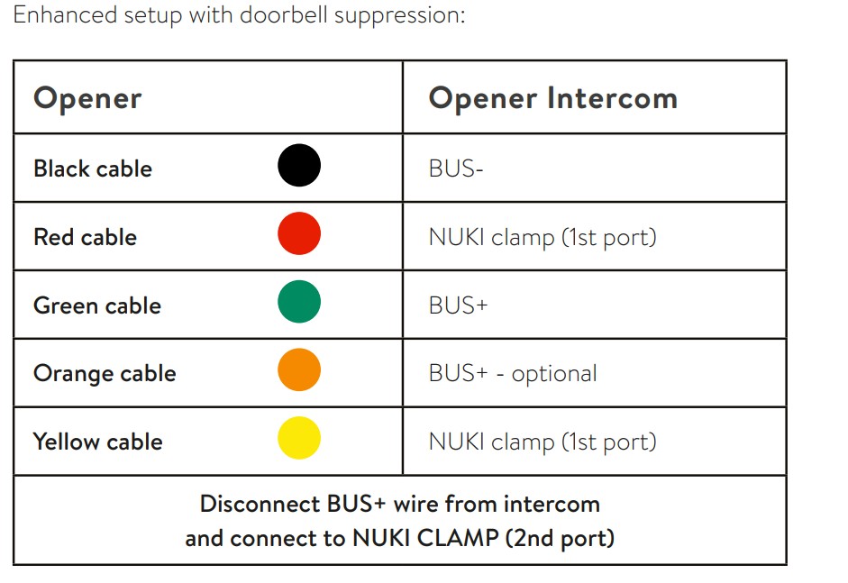

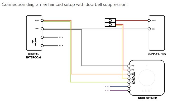

I tried the connection scheme form this post: Opener - Bticino 344912 - classe 100 v16 - working

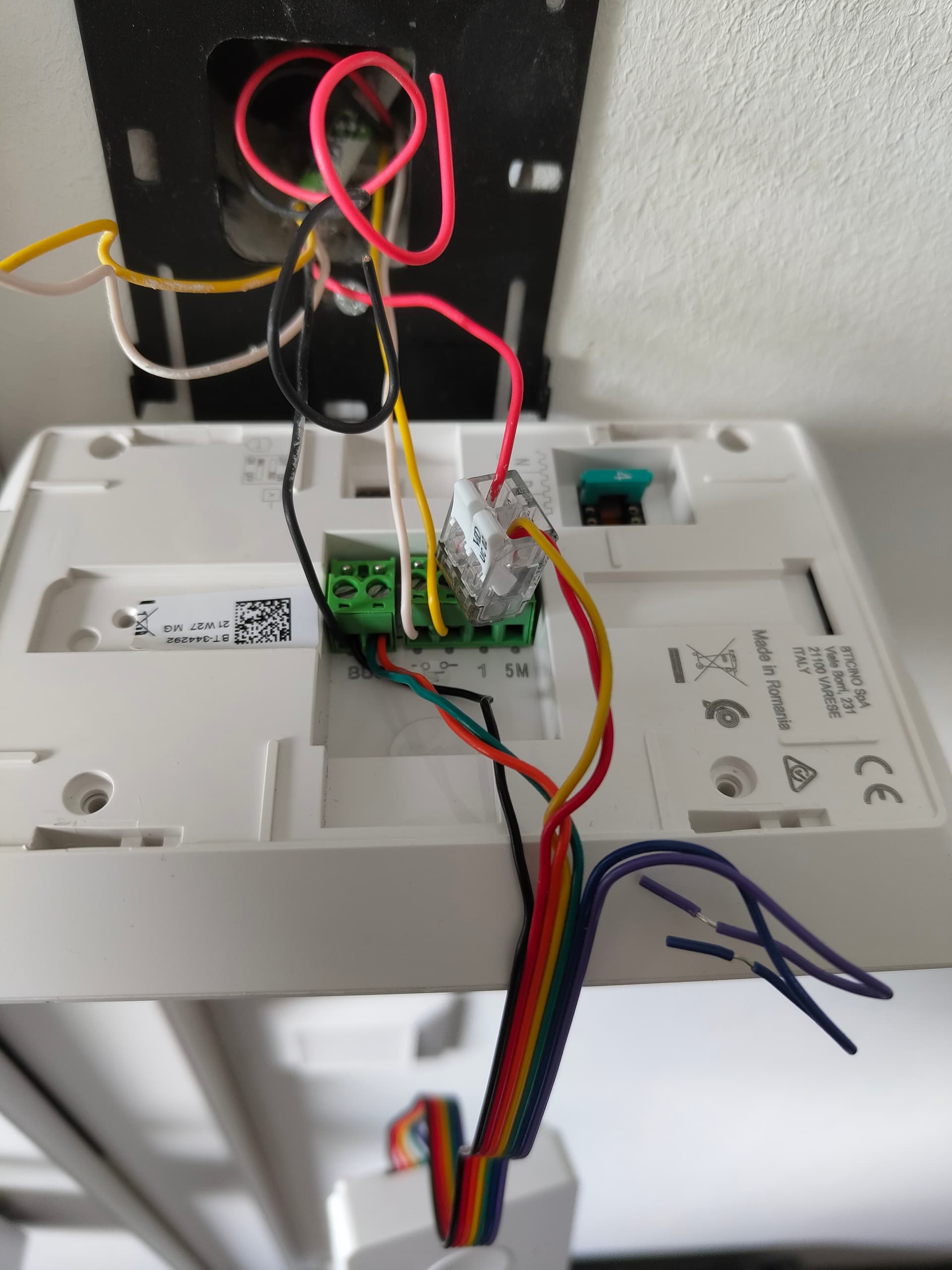

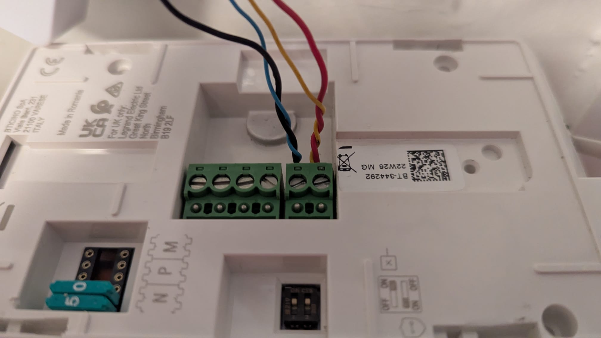

Hi, I hope this picture helps.
Thanks a lot,

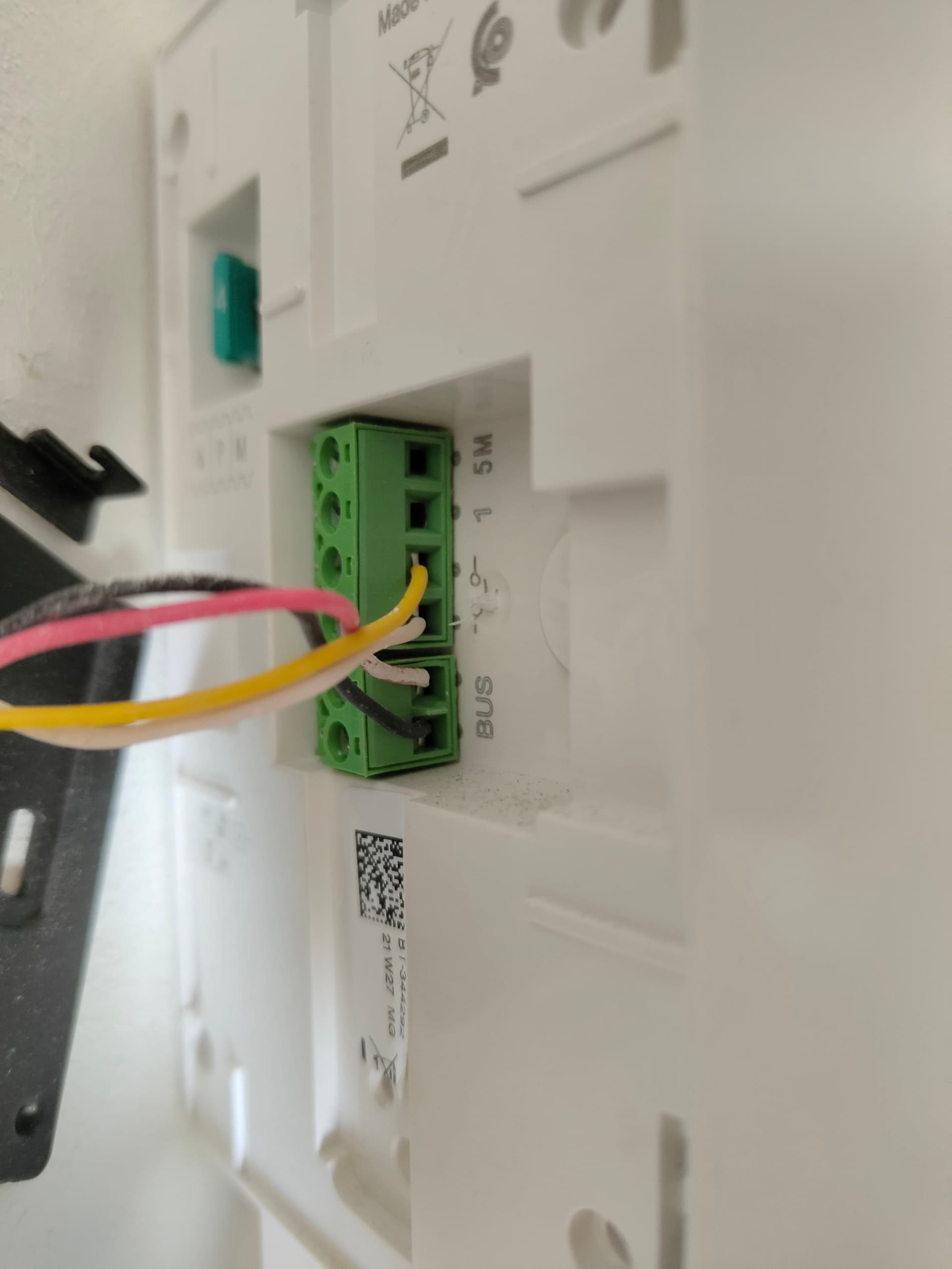

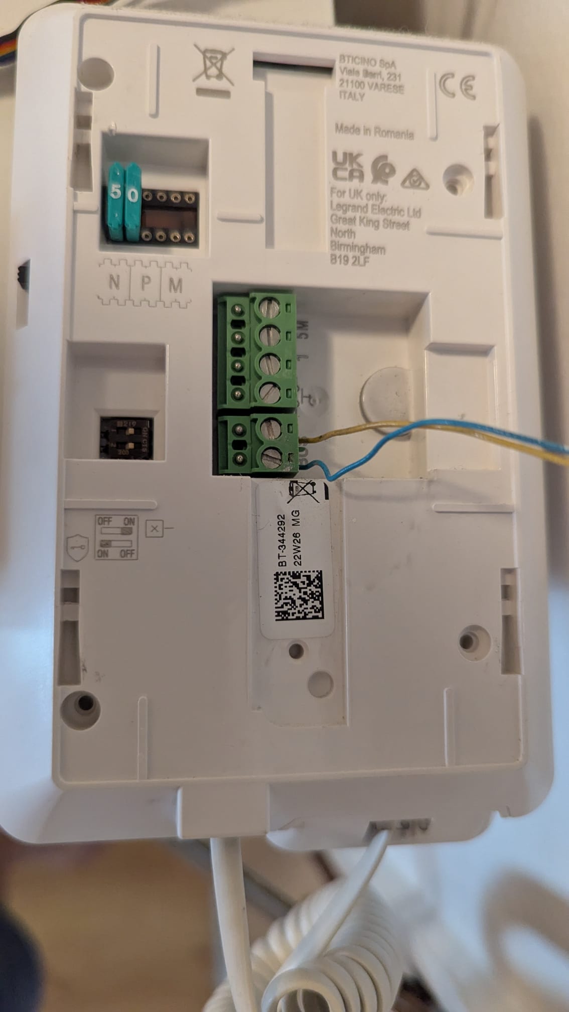

what was your original configuration?
mine was simple with only 2 wires

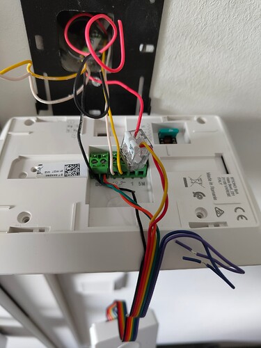

This is what it looked like:
Thanks a lot, on my side.

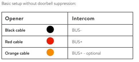

I only had 2 wires:
it works with only the 2 wires (Red and Black)
as the basic setup described on the website.

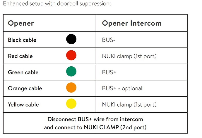

i finally received the Nuki clamp that i was missing.
i plug it just like it says on the how to guide
