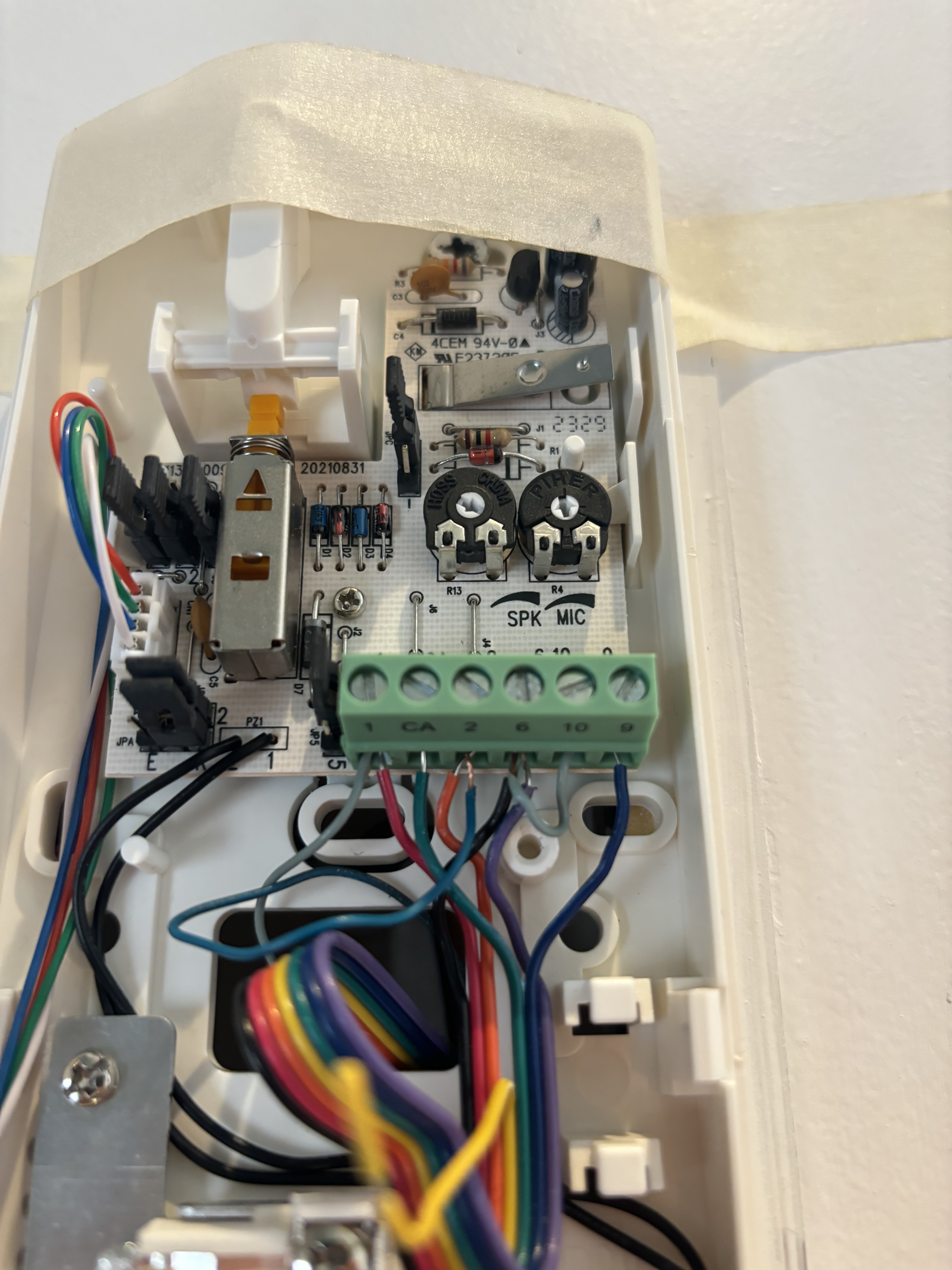

The connection are this as Luigi Mazzoli as write:
Red > 1
Purple + Black > 6
Green > CA
Orange > 2
Blu > 9
and 6 and 10 togher
as I posted in photos
hello, thank you for your answer, but I lost the door opening with the conf above. It does nothing when I ring either. Did I need to keep the 2-9 together and 1-10 together ?
Hello,
thank you very much Alex, I remade the bridges 2-9 and 1-10 and I said in the conf there was a ring, and it now works. In the configuration that It opens when I ring from downstairs.
Super ! thank you very much !
Théodore
