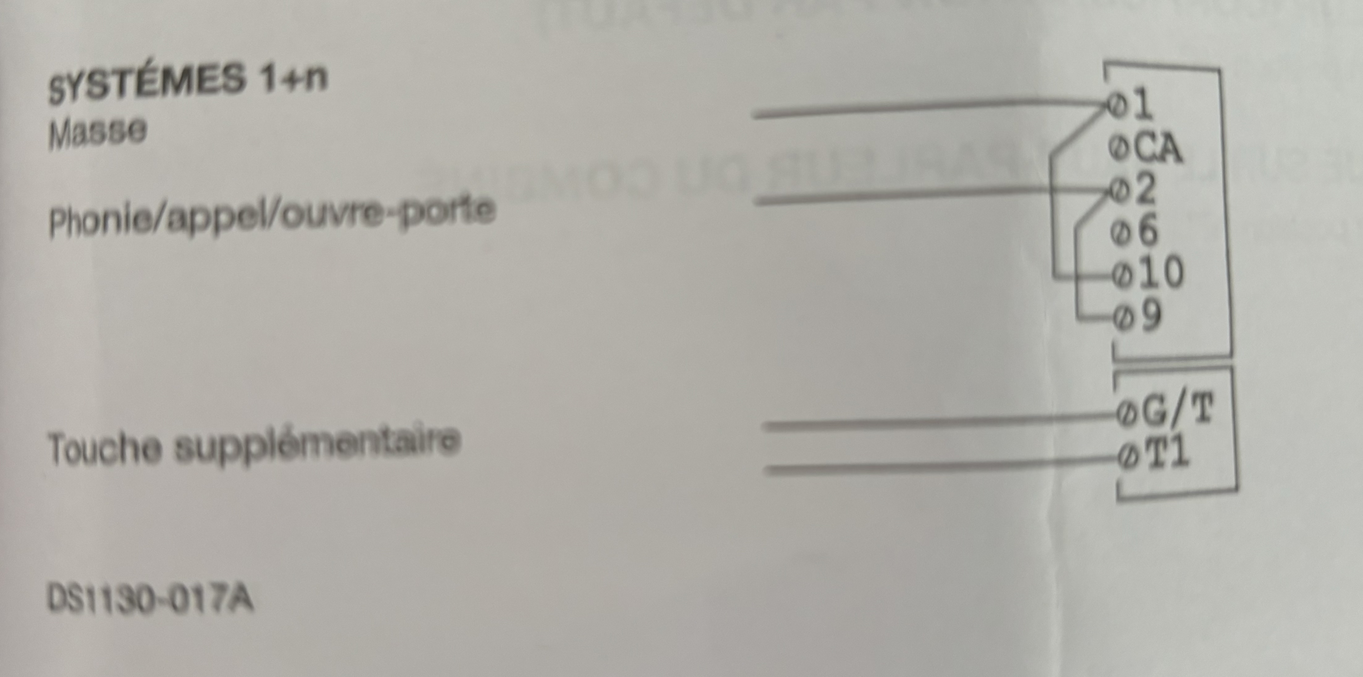

Hi, so in the end you were able to get the opener to work fully with the 1130/16? I have the same model but without external bell, so the CA is connected. Also there is the jumper between 6 and 10. Can you tell me if the scheme to follow is right?
Thank you
For anyone with problems with this model I can say that it is perfectly compatible with the URMET 1133/15.
Tested and working.
Also with 6-10 jumper.
So in compatible models you can also add the 1130/16 :smiley:

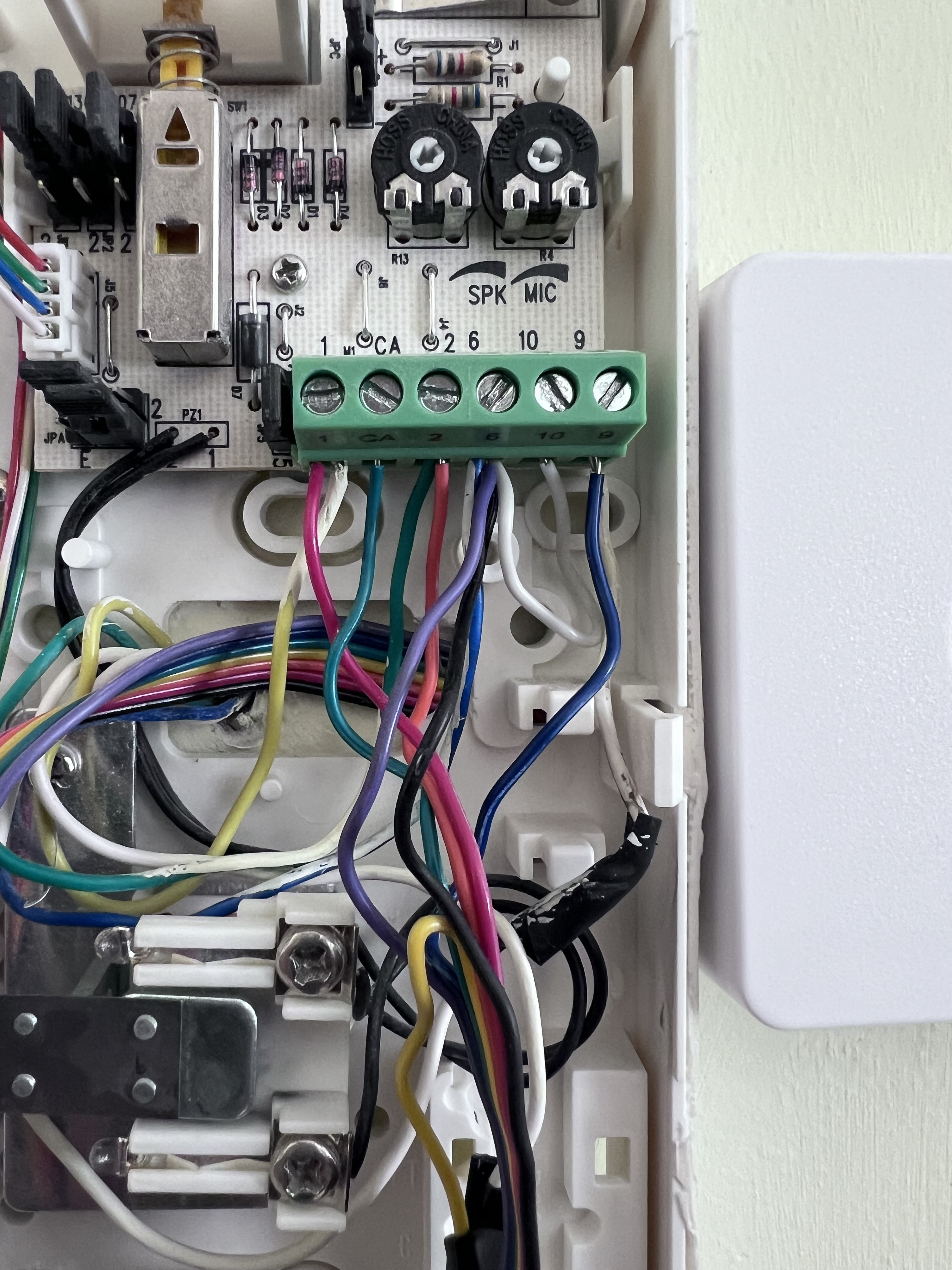

Hi Luigi, I believe you are Italian but I’m writing in English.
I have Urmet 1130/16. I’m not able to let it work properly.
This is my working configuration without Nuki Opener,
Please can you tell me where to put the wires correctly?
Thank you very much.
Hi this is the connection
Hi Maria Cristina, yes I’m from Rome :wink: have you tried to follow the scheme I already published on a previous post? That’s the one I’m actually using in my setup and for a sake of clarity I write again for you down below.
(Nuki) (Urmet)
Red > 1
Purple + Black > 6
Green > CA
Orange > 2
Blu > 9
If you have already experimented this connection schema without success, feel free to write me back with some more info as for example what function doesn’t actually work and which one does. Ex. You are able to hear, open but no rings, etc… Good luck :crossed_fingers: Luigi

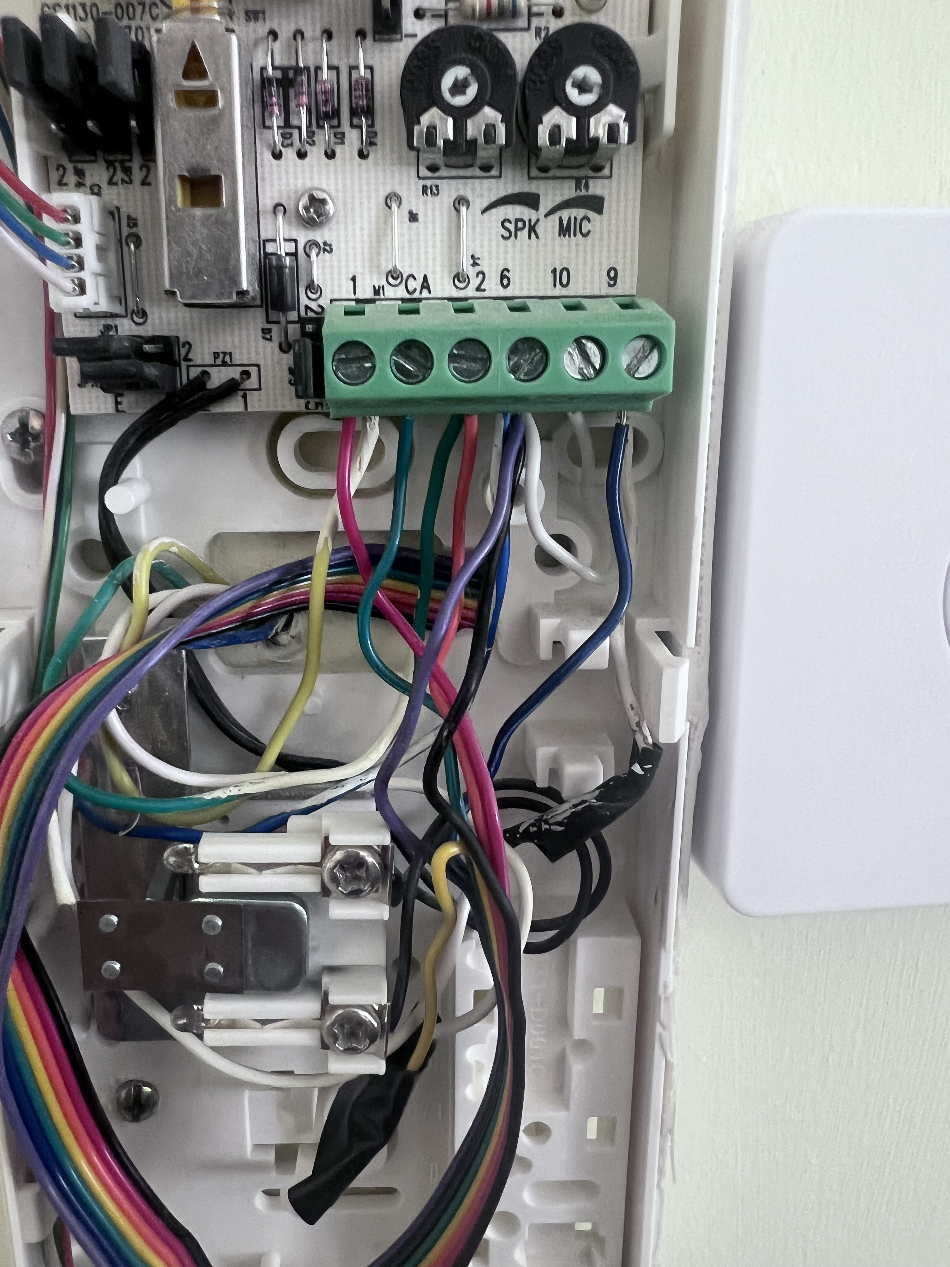

Thank you Luigi!
I finally made it following your schema! It perfectly worked and I’m very happy about it! Thanks a lot for your help.

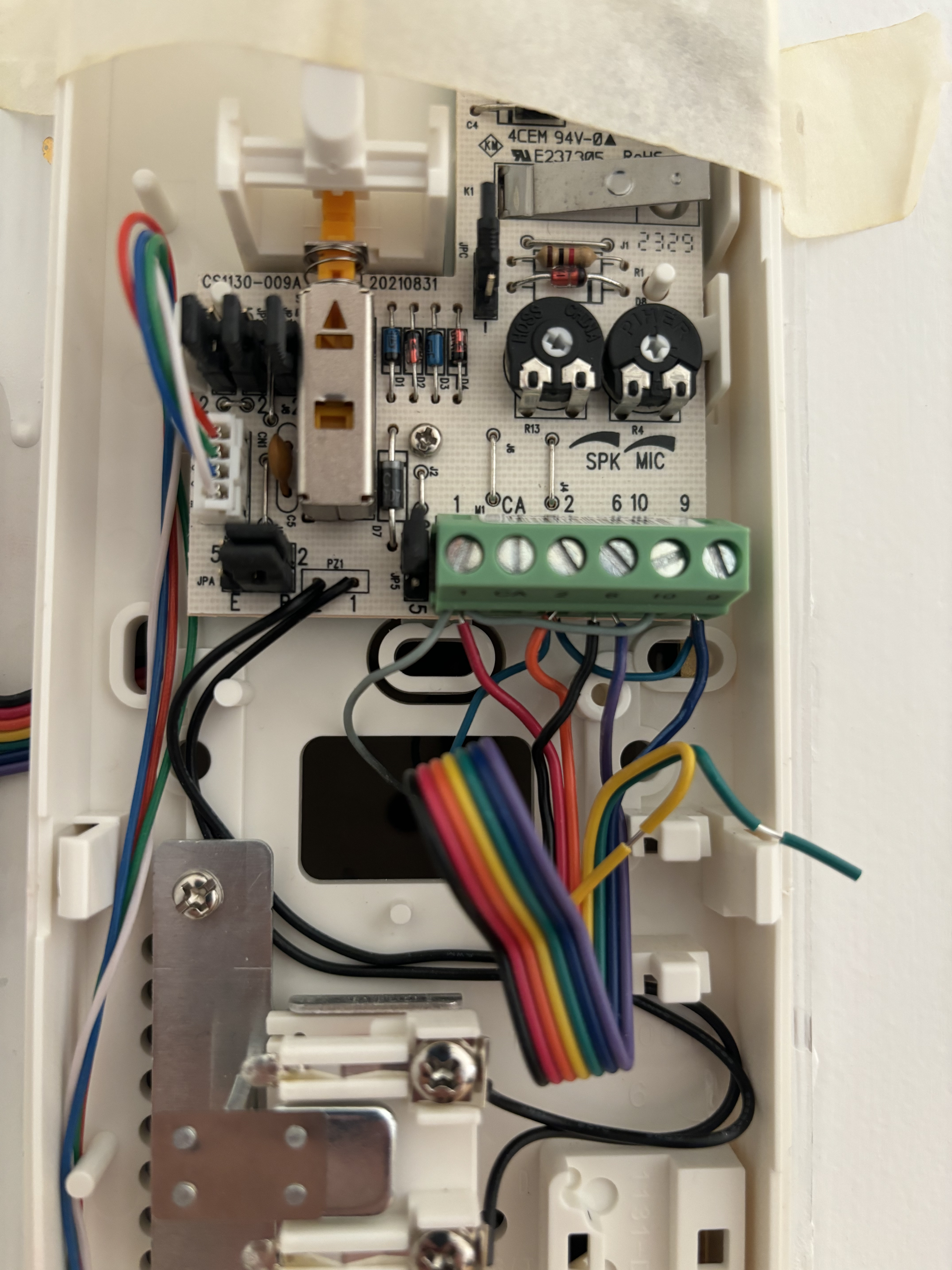

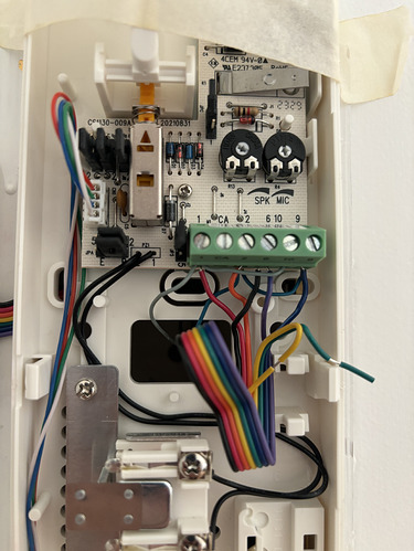

Hello, I hope you are going well. I have troubles to install the opener. I have 2 wires coming out of the wall for the interphone. I recently connected the Urmet 1130/16 and I struggle to install nuki opener (I have as well nuki bridge.) I finally manage to open the door downstairs using the app. My objective is to open the door automatically when somebody rings, with no action from my part.
→ Can you please help me ? What did I do wrong ?
Here is a picture of the wiring of the system. Can you please help me ? Thanks a lot in advance for your precious help!
(1 and 10 are connected together and 2 and 9 as well).
Hi, if you can open the door then the connections are correct, you just have to set the app to “Continuous mode” which you can find in the Ring settings
Hello, thank you, I tried that. It seems that the nuki does not know when it is ringing and therefore does not know when to open the door. I can open the door with the app, because I hear the buz in the intercom, not because the app tells me someone is ringing.
