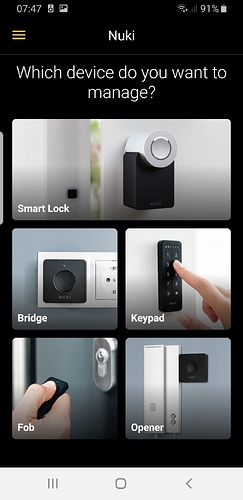

First press Manage Bridge
You will then see
