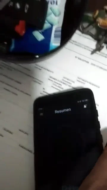

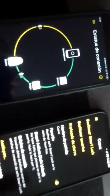

As you can see I recorded a video, so that you understand it better and solve the problem since it is only in this latest version

I upload a video for you to see, but we are not the users who must find the bugs and solutions
