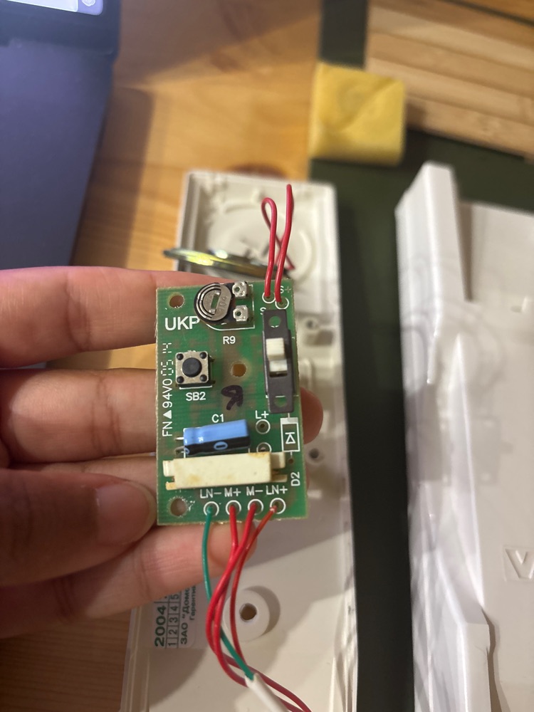

I’m trying to set up a Nuki Opener with an VIZIT intercom system and wasn’t sure if you’ve ever worked with something similar.
It looks somewhat related to this discussion, but the board I have isn’t exactly the same. I tried following the steps described there, but it doesn’t quite match, and I was hoping you might be able to share some guidance or point me in the right direction.
Thanks a lot for your time!
What I have figured out
State Voltage (V)
Idle ~ 0.1
Incoming call (no ringing) ~ 1.7
Incoming call (ringing) ~ 4.5
Opening door
Second important thing that I found - that breaking circuit while intercom have incoming call will make door open.
Image of the board
