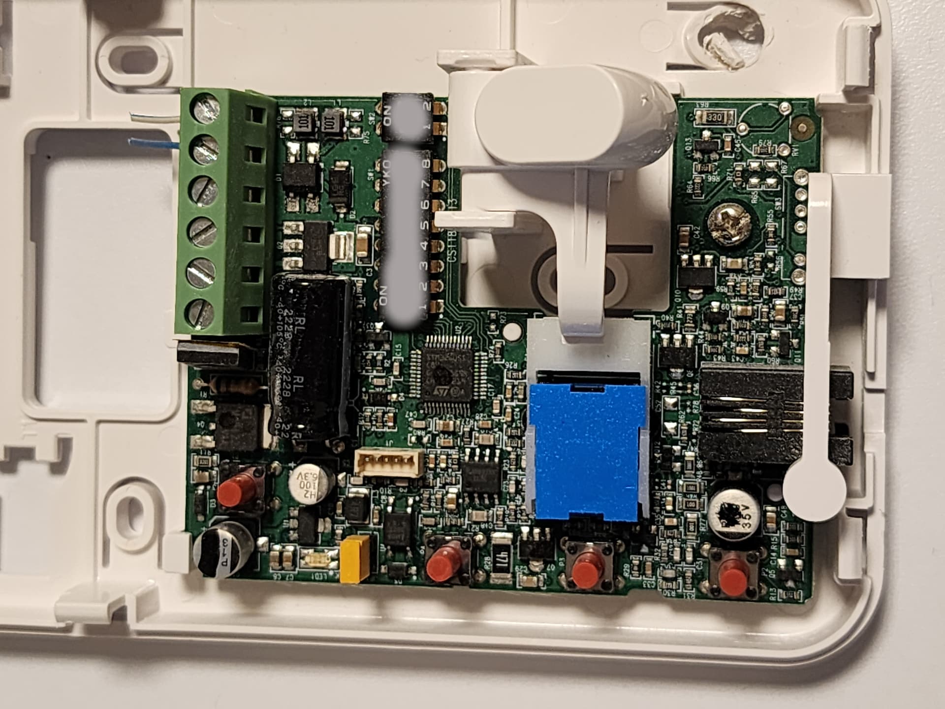

So I have a 2Voice system in my building, and I’ve pried open my 1183/5 secondary unit.
Turns out there is an undocumented 5-pin JST connector there. Didn’t check yet what passes on these pins.
BTW, according to Urmet’s documentation the voltage in the system is 38-48VDC.
