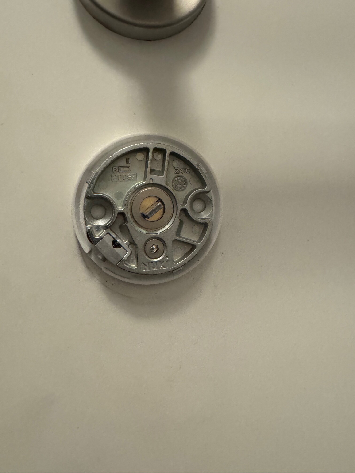

In cases when mounting plate B needs to be attached to the round rosette there is not enough surface area to hold the lock firmly in place. With the time it is going to fall off.

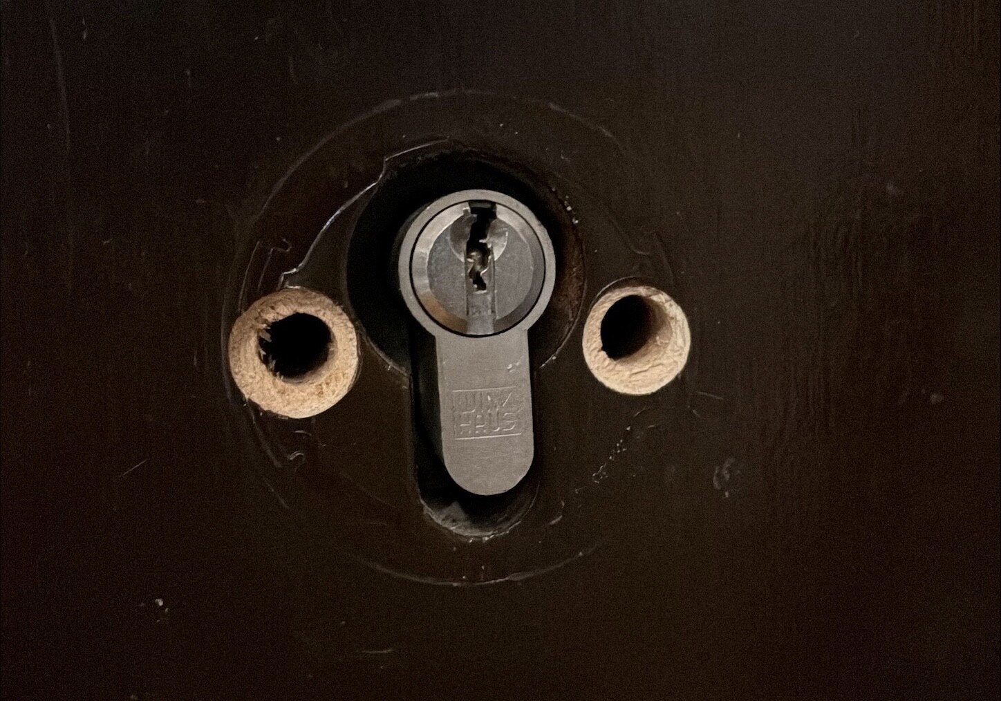

On the outside this internal rosette is also holding an external one with two bolts that are positioned as shown in the picture below:
Features
Internal rosette can be taken off and replaced with modified mounting plate B as shown in the picture below.
Reason
It is quite common in Germany to have the rosettes used on the doors and they are all fixed the same way with two bolts going through the door. If the holes were available by defaul on plate B it would mean that the lock can be mounted directy on the door with a much better hold than using the standard sticker.
Updating the plate with additional standard holes for rosette replacement would create a solid option to mount the lock without additionally drilling the door.

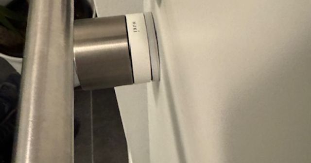

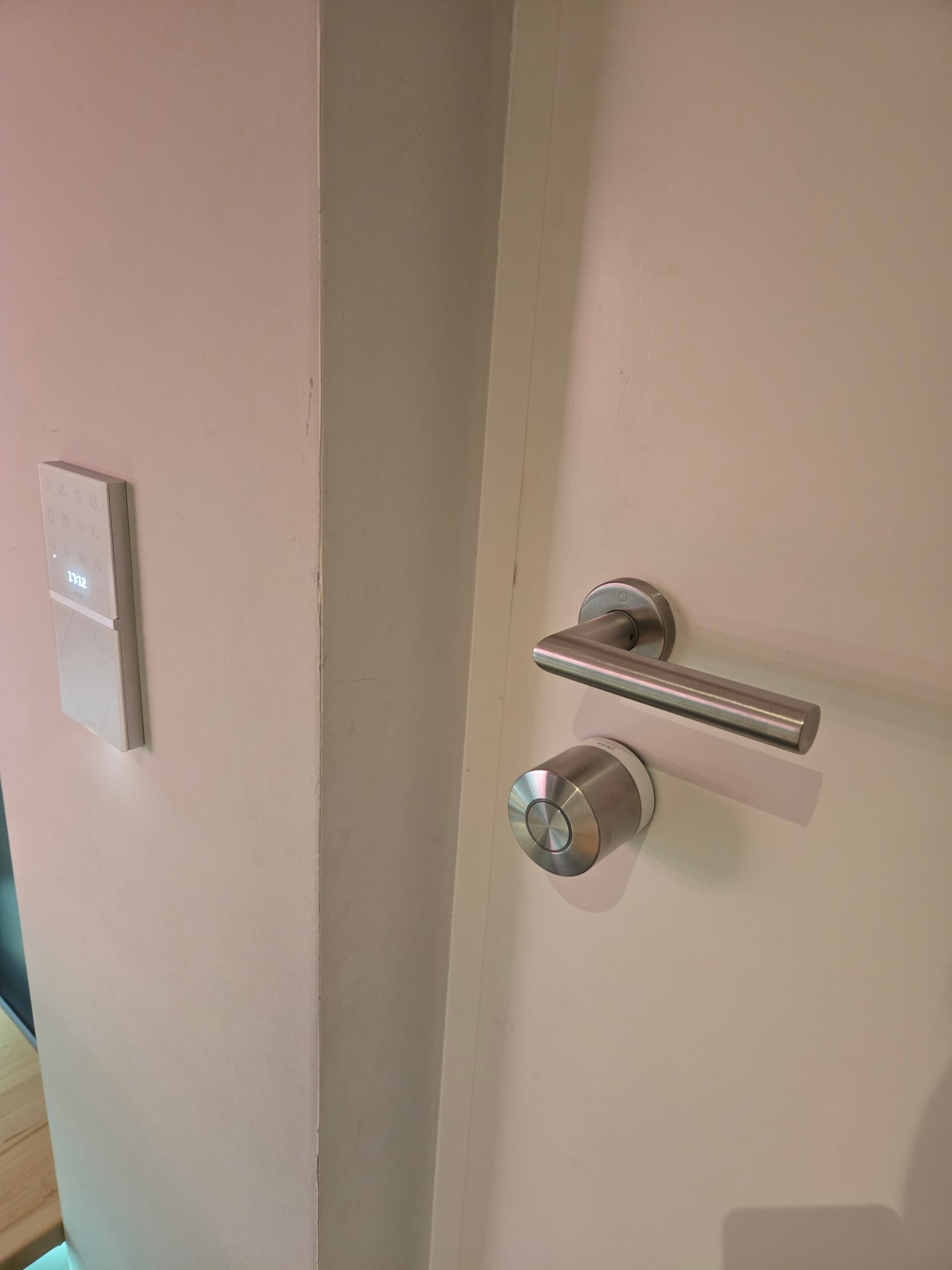

Same Feature Request here; as of today I have installed my very first Nuki and the Gap etc. with the Mounting Plate A is looking a bit weird and seems to be unnecessary.
(I have only removed the rossete for the photos)

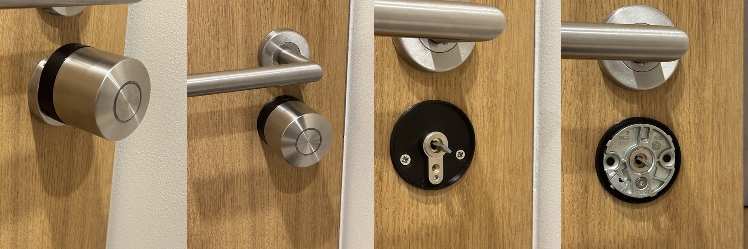

Next test will be with:

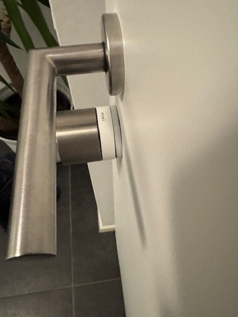

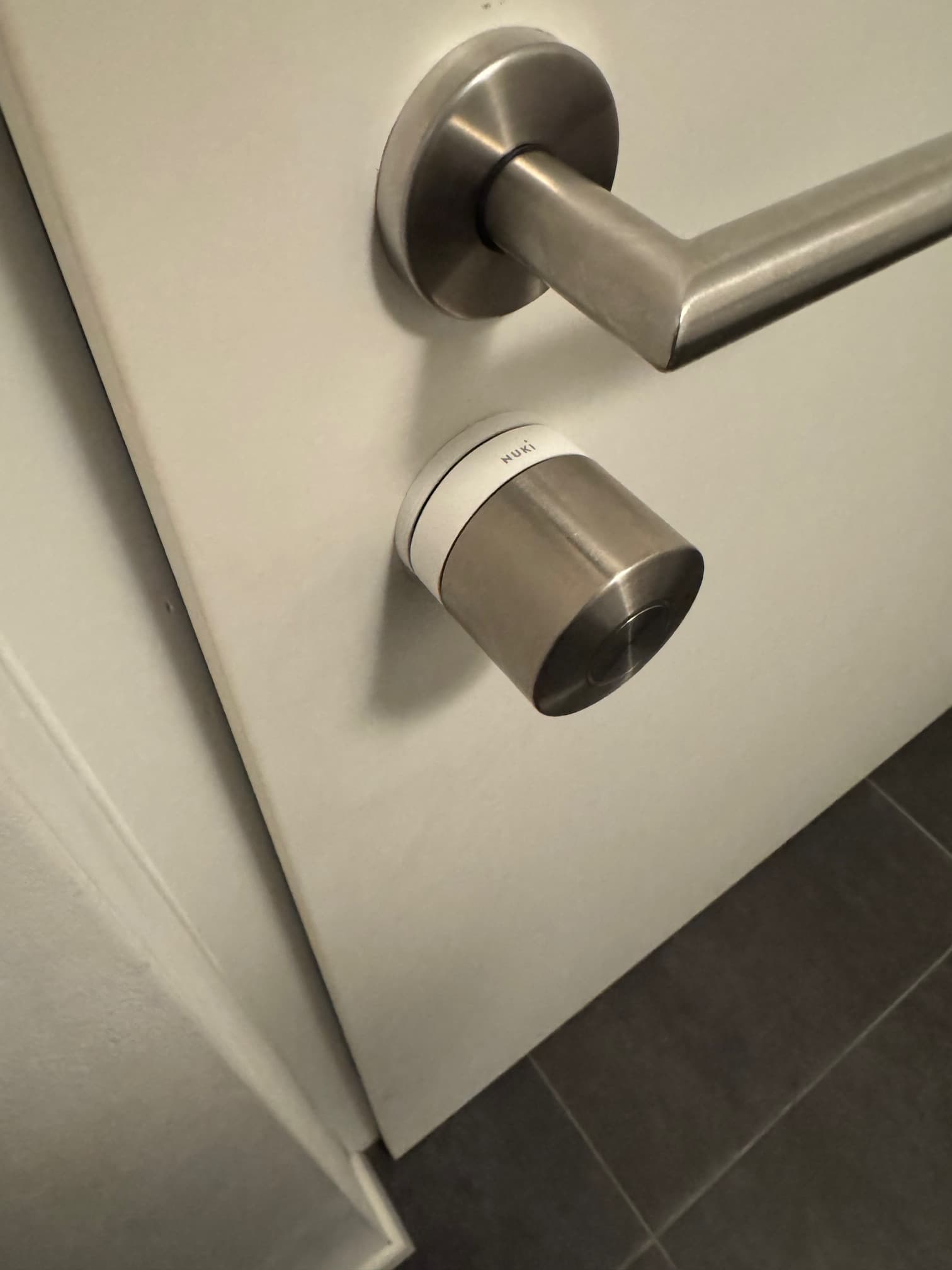

For (initially) testing + photo taking purpose I have removed the rosette and screws completly today.

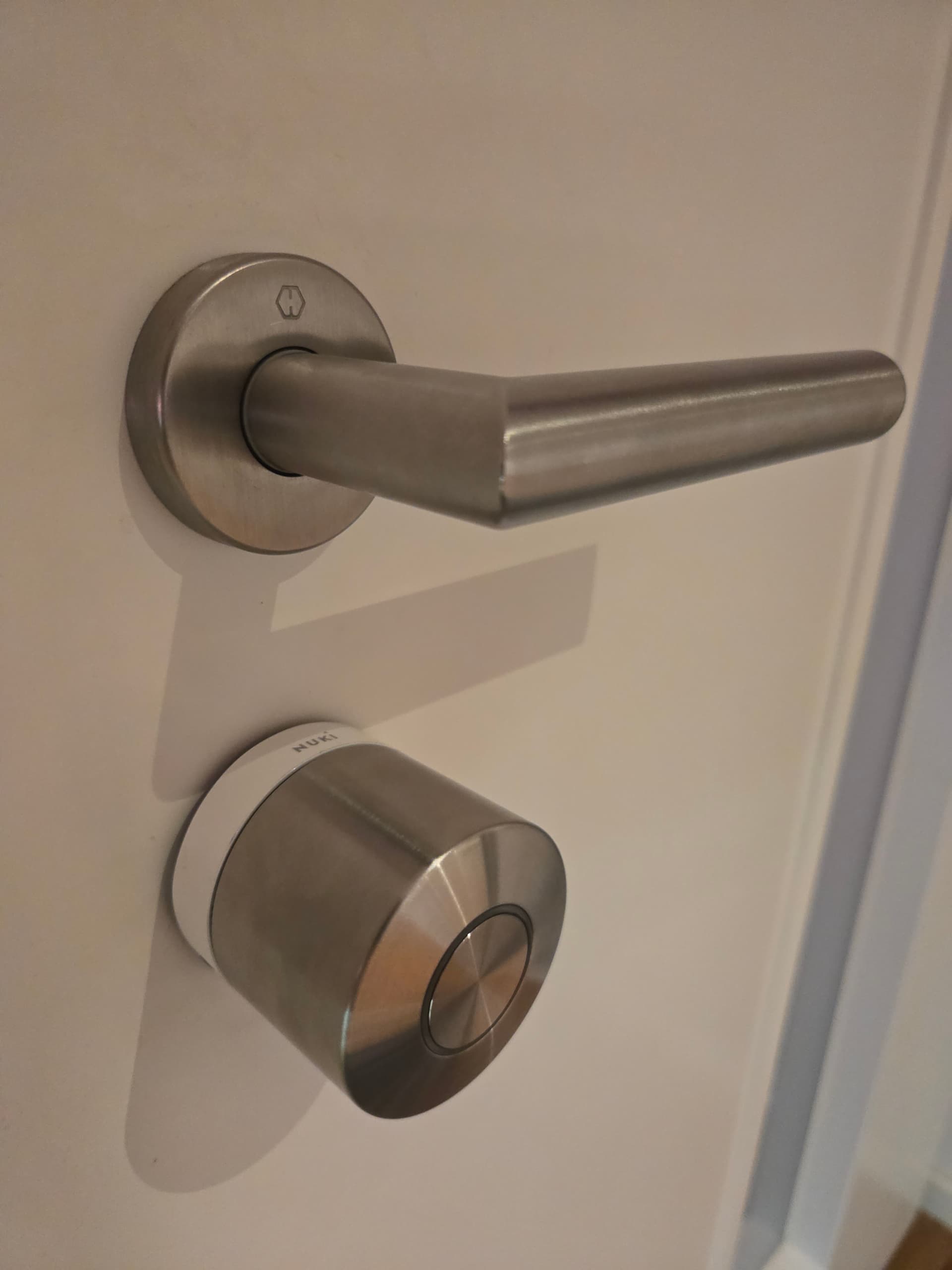

Very much to my surprise, I was able to use the rosette screws even nearly flat directly on the wood-door. After that I have shortend the Nuki Universal Cylinder on the inside and et voila, I was able to mount the SL Ultra perfectly :slight_smile: AND and that was crucial to me, I only have an very very very small cut visible under the SL.
With that new Setup in place, the SL Ultra is an 10/10 for me!
(Only thing which I have to talk about with the support is, that the Ultra is a bit “squeaky” when turning the lock)

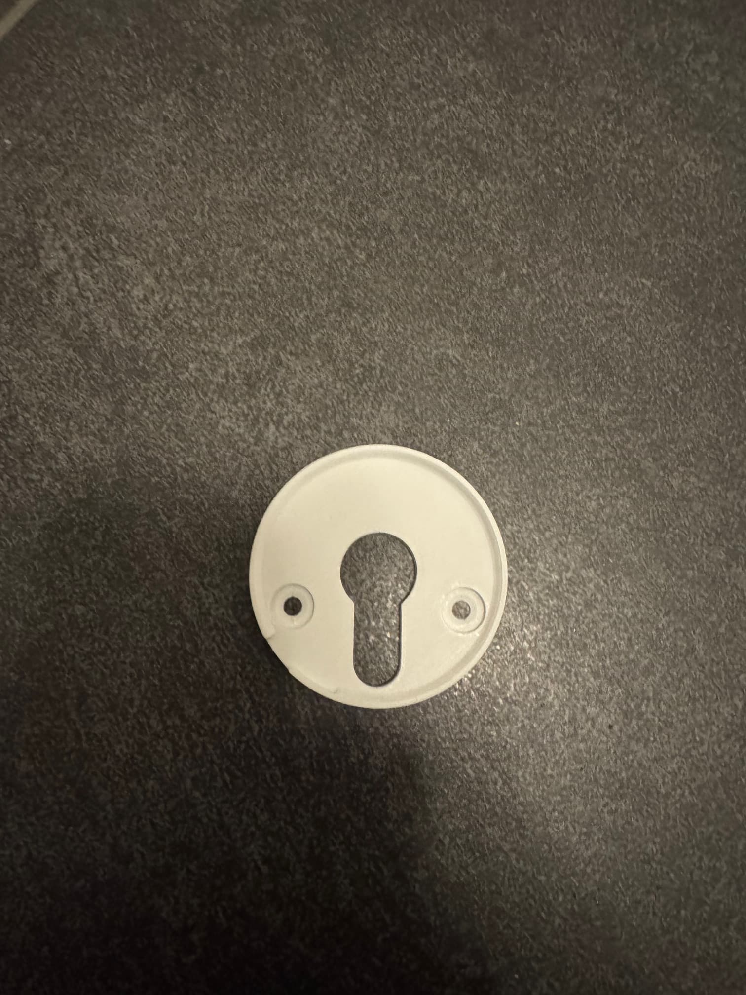

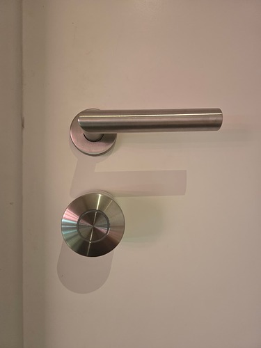

I’ve designed a low profile plate to hold the outer rosette and mount the Nuki Ultra closer to the door
Ideally, it should be CNCd out of metal, as the plastic could be less secure.
I’ve uploaded the 3d models here: Nuki Ultra low profile eurolock plate by alexey | Download free STL model | Printables.com

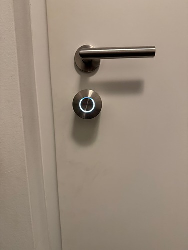

Hi Alexey, I printed ur mounting plate for the Nuki Ultra Lock. Unfortunately my screws are a little bigger and dont fit in the screw holes, so the plate dosen fit perfectly on ur Print. The other Thing ist that i had to use a second Plate to double the Space because me door is in between too sizes of that nuki cylinder. Could u maybe upload that files in STL format so i can do a remake fitting for my door? I cant open that STEP format in my editting software. Or maybe u would be so kind to change the bottom of that print to double the thickness and do a litte screw outage of about 10 mm in bothe screeholes
of half the way of the Thickness of the bottom, so the screw can slide into the material.
hi i remixed the model of alexey to fit my german door with bigger screws… here the model link and the pictures:

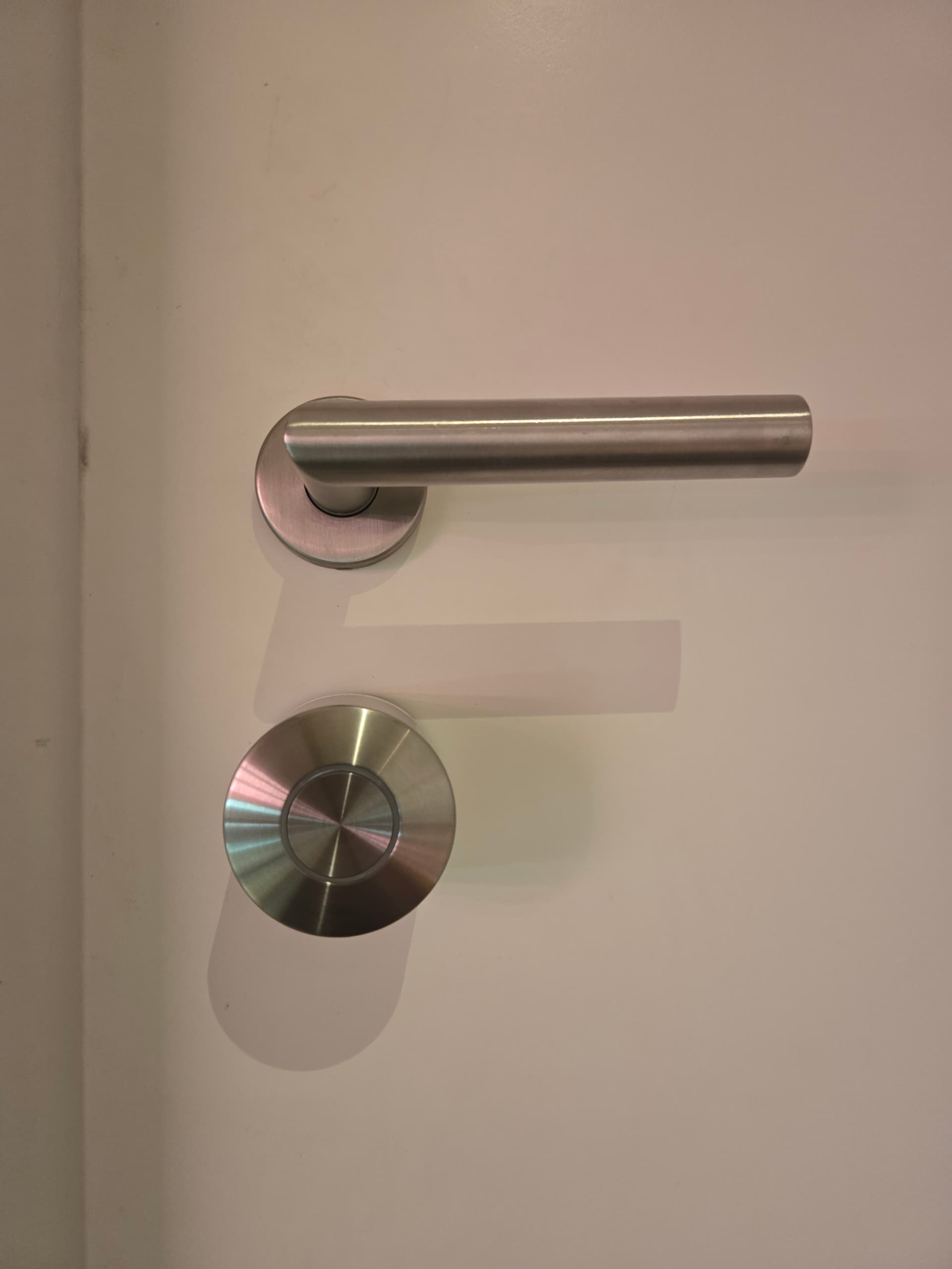

My thoughts on solving this problem (that do not result in a less secure solution due to „outside Rosette can be ripped off way easier, because the inner rosette was replaced with a 3D printed plate“):
  1. Remove the inner rosette and the screws that link the inner with the outer rosette
  2. Find grommets that „fill up“ the hole r only protrude a little bit
  3. Push he Original screws through the grommets. Then fix the outside rosette
  4. Mount the Nuki (Pro or Ultra) with the original Nuki plate on top of the grommet(s) and the screws
If I’m not mistaken it should result in a sleek optics but still a secure structure.
Any thoughts on this plan?
