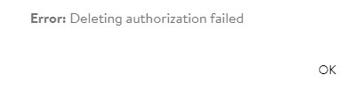

Hi,
I have a problem when deleting an entry code through the API returns OK but the code is not actually deleted. Then it gets stuck and is impossible to delete neither using the API nor in Nuki Web. Adding/removing new codes works fine, just that one is stuck now.
