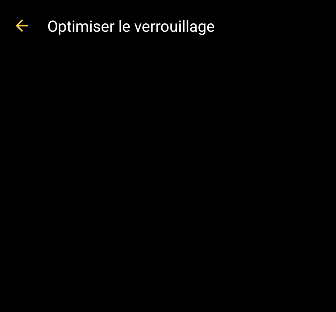

Custom configuration page is empty (only black without any elements) on my phone (One Plus Nord ce 3 lite 5g, Android 15 CPH2465_15.0.0.1360 (EX01V120P02)).

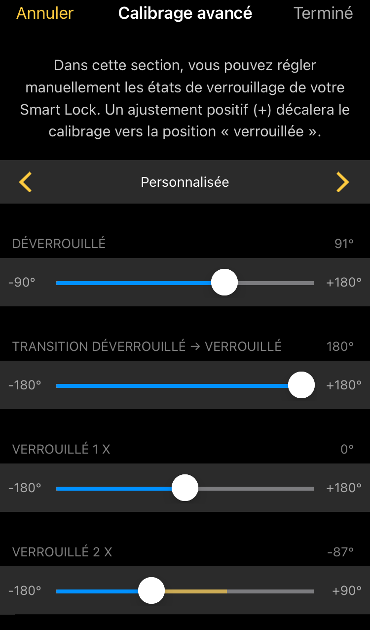

I have tested with an other kind of phone based on a fruit and I see all custom parameters.
I only changed the value of “Verrouillé x1” or “Lock x1”
And now it is working :
  • Action Lock with handle lift-up : ok, status is lock
  • Action Unlock : ok, status is unlock
  • Action Lock with handle not lift-up : ok, status is unlock (with error motor in the application, but I will not use the app in everyday life)
That would be great to have a description of advanced calibration parameters (such as suggested here
SmartLock: description of advanced calibration) and to add this subtlety (“door cannot be locked” according to help but status is anyway changed to “lock”)
