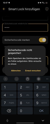

Hello Community,
I just have received my SL Ultra but cant integrate it because the individual Security Code cant be saved.
Thus the Setup process failed. I already created an regular Support Ticket but would like to know if someone experienced the same?
App-Version: 2024.12.1 (1012)
Device-Info: SM-X510 Build/UP1A.231005.007
Google Play Services Version: 244738029
BLE connection method: AC-0

Tried (already) again but unfortunately this doesnt help.
I also tried to pair it manually within the Smartphone Bluetooth Stack but afterwards the behavior of the Nuki App Setup procedure/problem was the same.

Clearing App Cache and Data… was the quickfix for me
