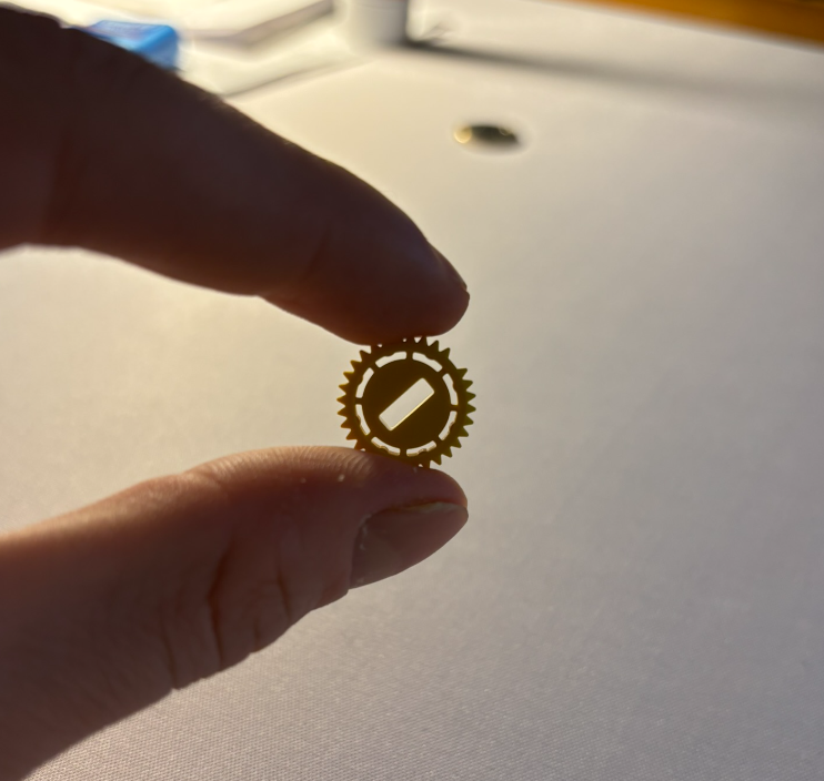

Hi there,
I have owned a Smart Lock Ultra that I got from the first batch back in January.
My yellow adapter is broken (into 2 parts); I have mailed Nuki Support 4 days ago with no reaction (I got an email stating that they have recieved my claim). Who can help me quickly - the lock is as you can imagine unusable.
Is there anyone in Germany who can send me a replacement part quickly - maybe 3D printed?
Thanks

I’m in France and got the same problem. I do not understand why this piece is not in metal.
This is one of the most important piece of the lock.
After having contacted the support, the guy send me a 10€ coupon code and I have bought several of them…
I assume that they have not choosen to make the adapter from metal as the opposite part of the lock itself is from plastic too. Meaning in a jam the metal part could damage the other side of the lock. To me both parts should have been designed in metal.
I got the code as well, need to wait until the adapter is available again. Apparently they only had a few pcs available. Questionable for a penny part thet is prone to break…

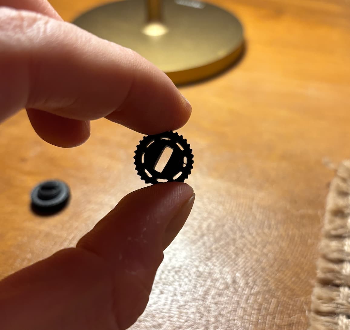

Also, I asked my friend to create a 3D model without these holders. One compact piece only. i’ll share it when it’s done and tested.
I’ll keep you posted.
Please do share when the adapter is ready

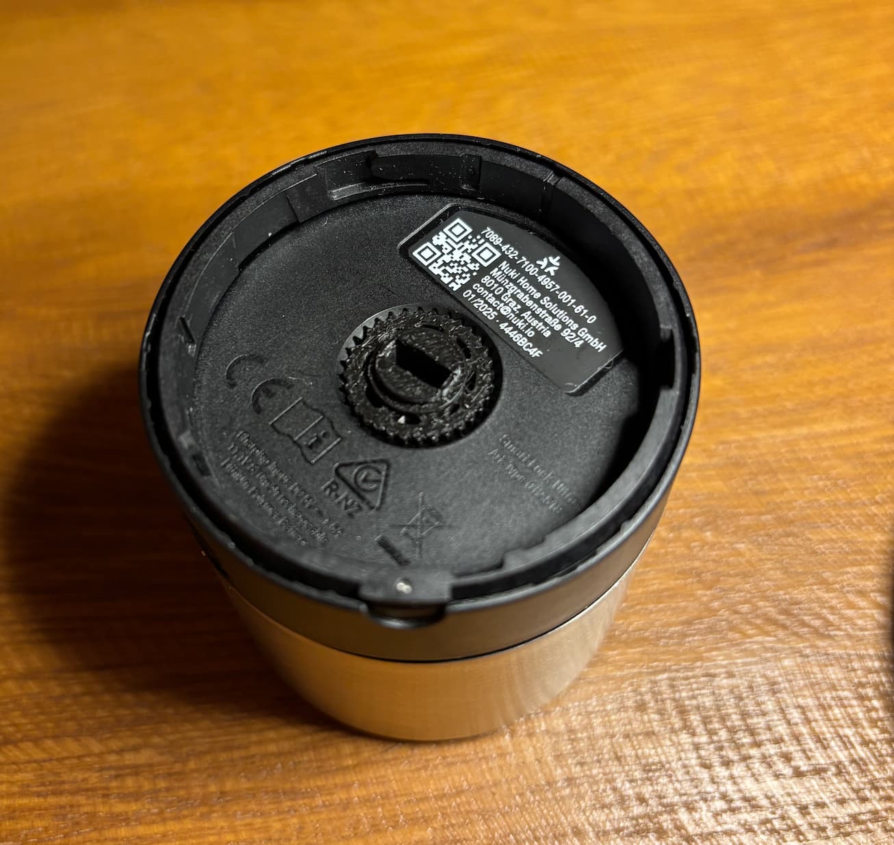

Ok, so I printed mine yesterday. I used this file: Nuki Ultra Cog Replacement (Spare Part) by CanWeFixThat | Download free STL model | Printables.com
Pins between both circles are stronger :muscle:

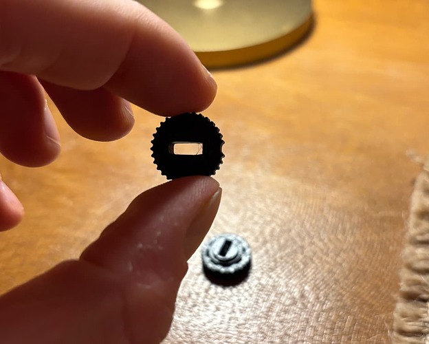

I also created another version without “security” pins (plain plastic). The basic version printed above works perfectly! I printed 3 of each :slight_smile:
The quality doesn’t look great on photo, but it fits nicely in the Nuki, doesn’t move, and does a perfect job.
Sorry for the multipost, Nuki community only allow 1 picture/post. The plain version (it’s not the one I’m using, and I don’t think i’ll):
