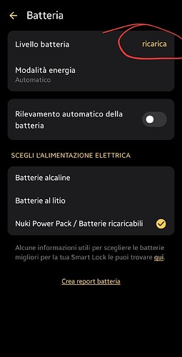

The same as before…
Nuki PowerPack with Energy mode in Auto…
But I tried changing all setting and the result doesn’t change
  1. And at what percentage of the discharge did it start?
  2. What are your impressions of 3.11.1 firmware compared to 3.10.7?
It started to report “recharge” tonight (checked trough HomeAssistant history) and current battery level is 62%
The only difference found vs previous FW is… this wrong report of “recharge”
This evening I will try to remove battery and see if the problem goes away (as I expect)
As I was eexpecting, removing and reinserting the battery solved the problem…
Now it doesn’t report anymore that it is recharging
I wonder why it did happen… was it a FW (new) bug?

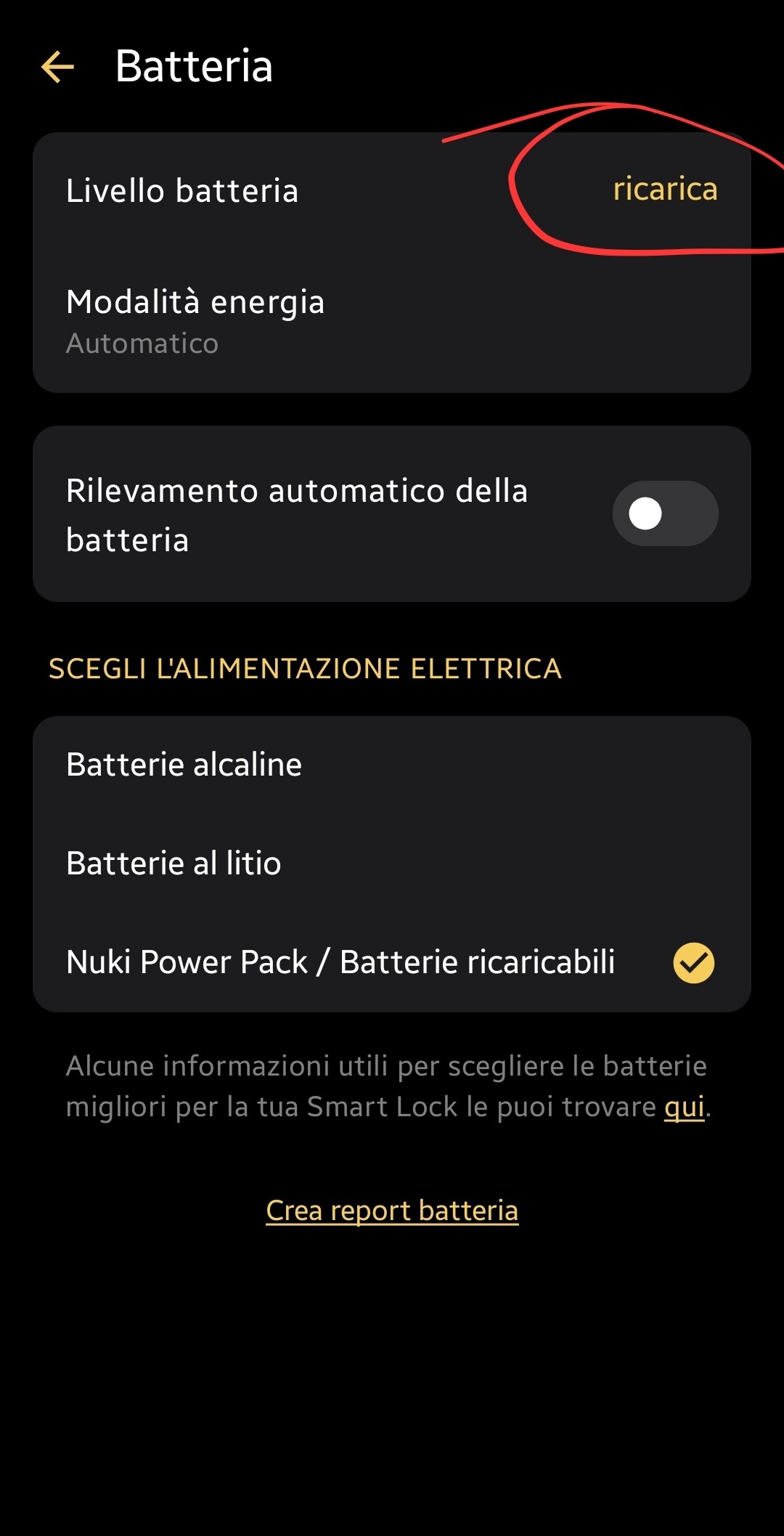

Again the same problem…
At this point it’s definitely a fw issue…
Pls solve it…
Thanks
Again the problem… and this time not after a battery recharge…
At one point I see the battery as if it’s recharging… but it’s not!

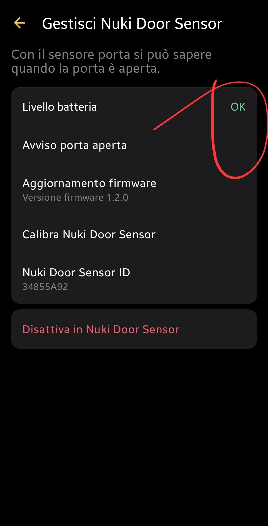

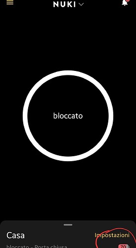

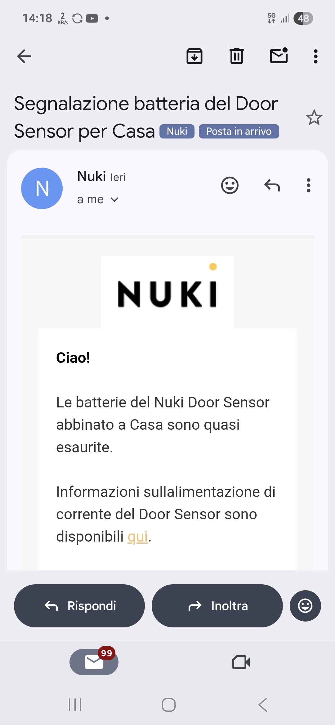

Yesterday I got notification (and email) about my Nuki Door Sensor battery down…
But now the situation is the following:
  • in the app I see the (Nuki) battery in red
  • if I go in Nuki Sensor settings it say battery OK…
    So there is a big contradiction…
    What is right and what is wrong?

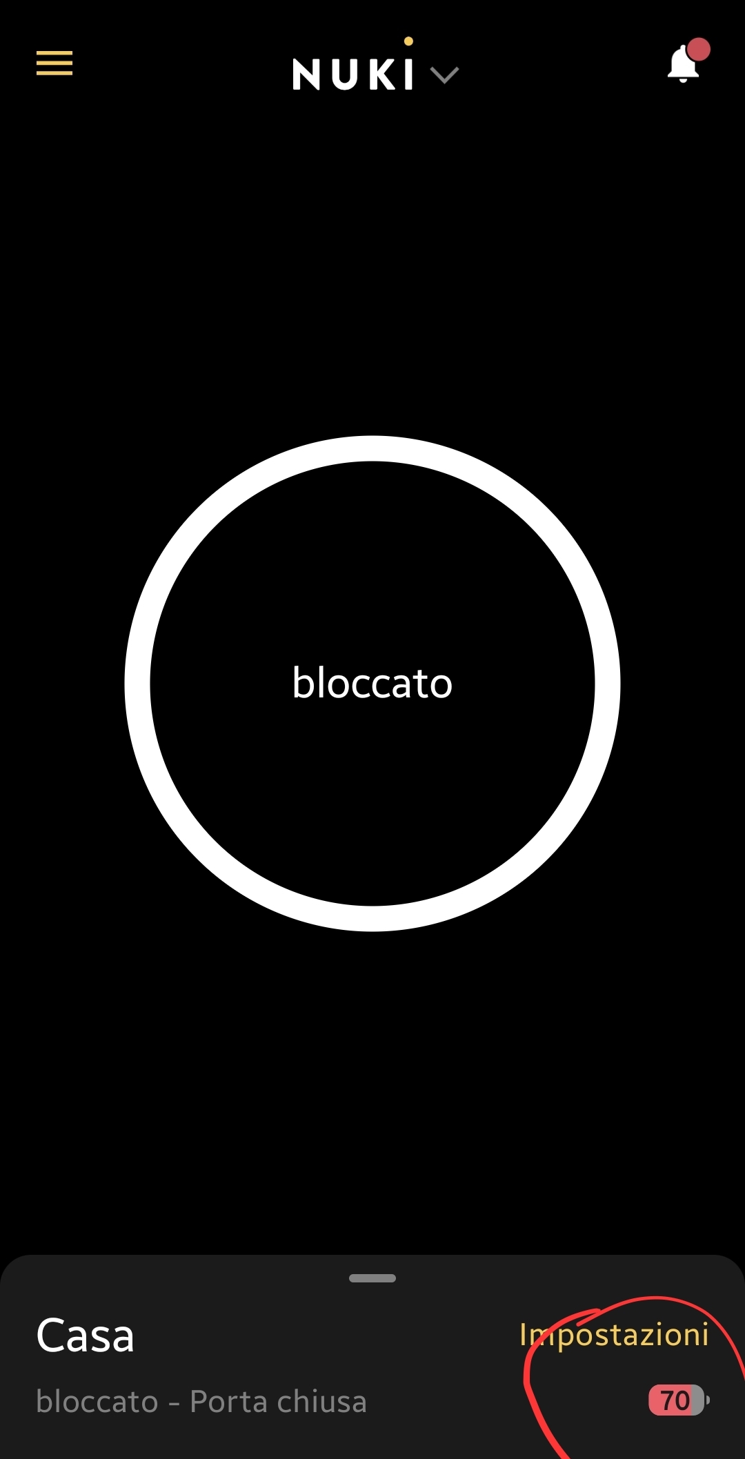

Again the same problem of fake recharge status…
I wonder if someone from Nuki is monitoring this forum… and does have any interest to fix those kind of problems
My feeling is that these kind of report are totally ignored…
Again… and again…
Does Nuki want to consider fixing this problem or not?
I want that you note that we are talking about Nuki Power Pack, so the battery that you are suggesting… that should work perfectly…

Last week-end I observed the same behavior as @spanzetta with my door sensor. Since I changed the door sensor battery the alert is gone from the app as it seams but before changing the battery, it was reported as “OK” in the door sensor information even within having the notification.
