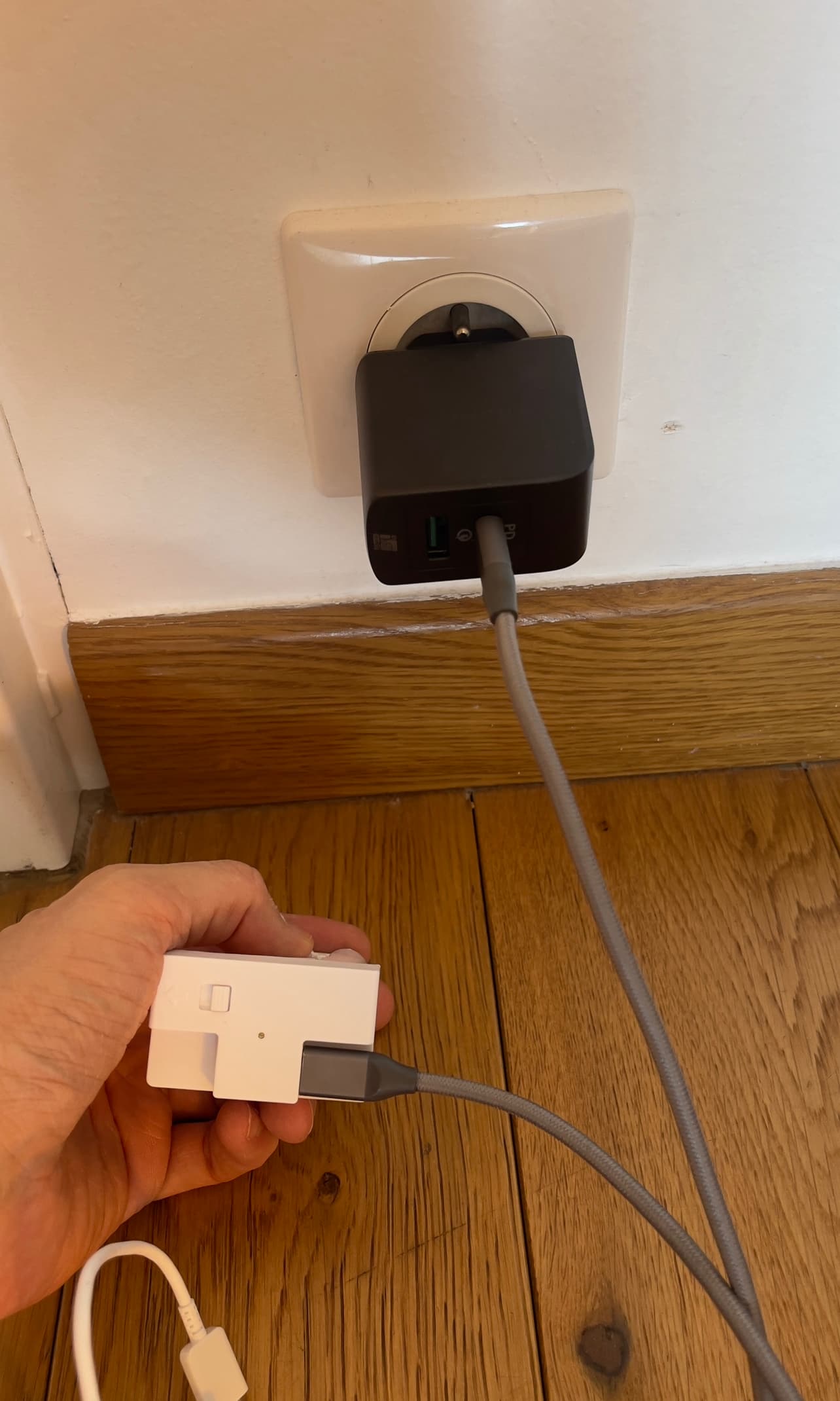

I go on vacation today.
The pocker pack is to 40%.
I have just noticed that cable USB-C to USB-C doesn’t work.
I have tried with different plug. Apple and other.

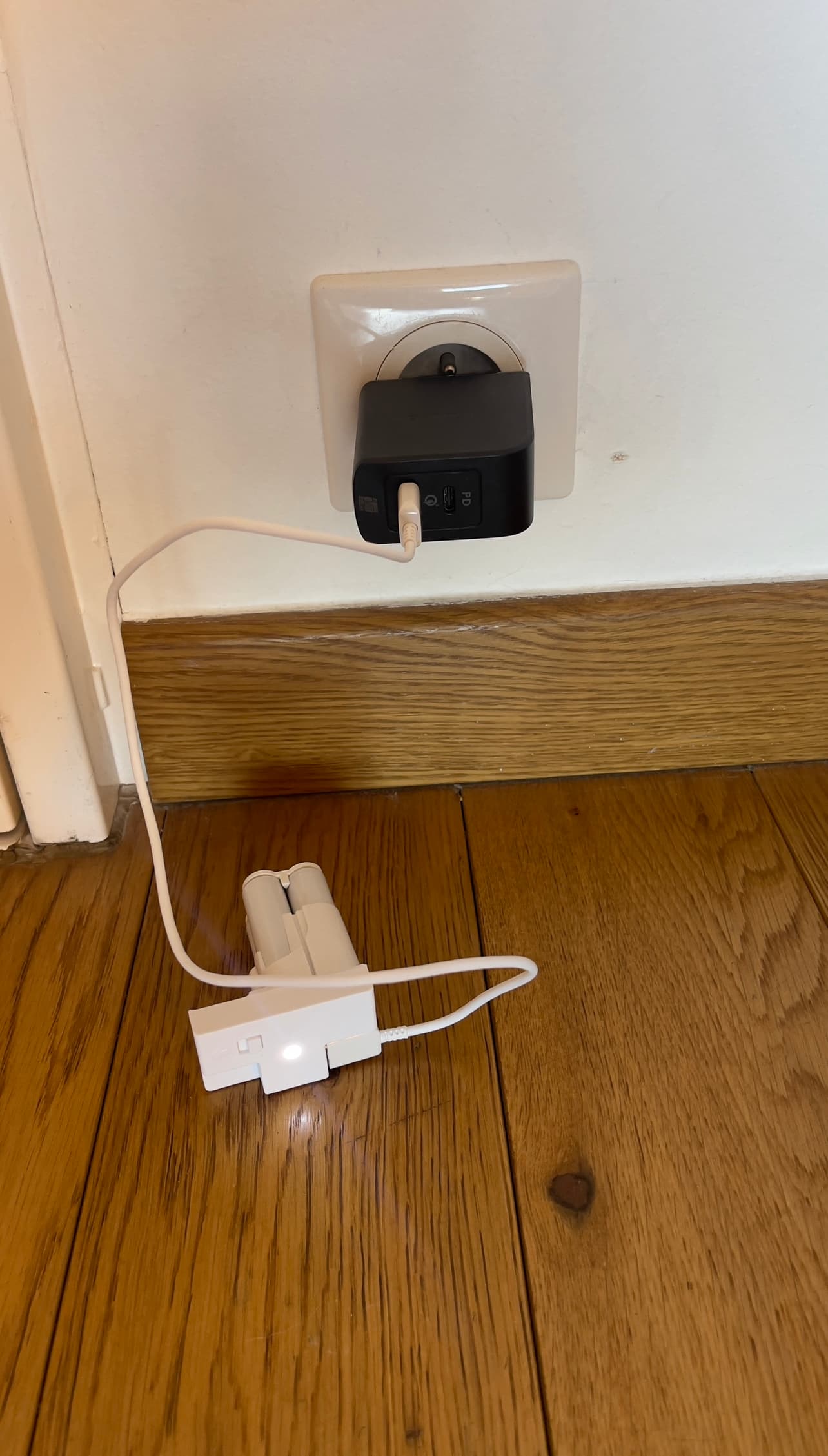

Only the nuki cable works fine.
Why ?
Why ?

I have connected long usb-a to c cables to load the packs automatically once a week, and no issues, - but when usb-c to c doesn’t work, is not good! Do have usb-c to c maybe a lower power-strength-restriction as usb-a to c!?
I don’t know about the cable usb c to usbc. But i tried with two different cable.
An apple cable
And the cable that you see on the picture.
Both didn’t work.
This is really strange!?
