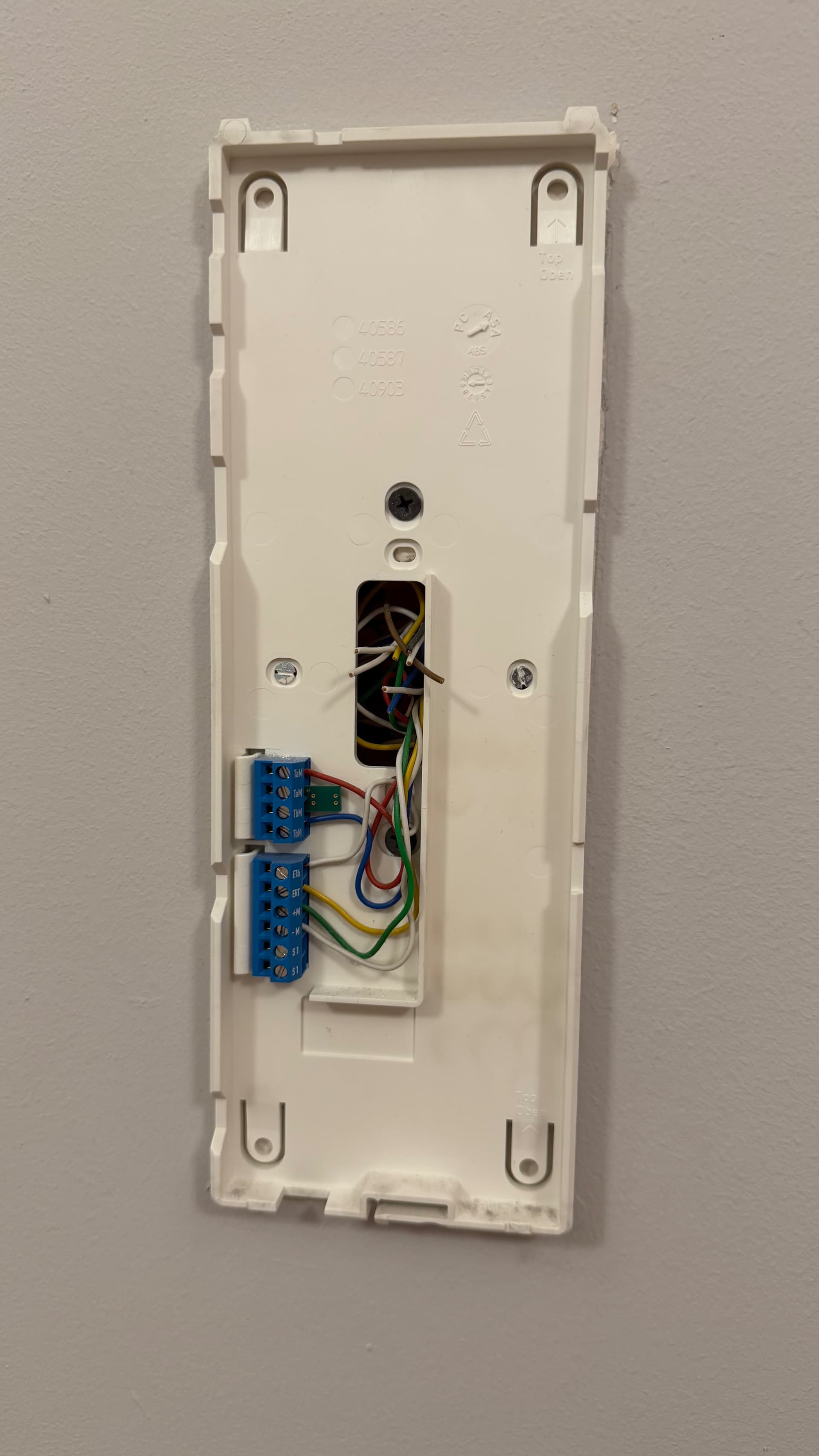

Opener has been installed and wired as instructed by the app - checked several times - see photo
from top to bottom:
green and orange from Opener to TaM
Abschlusswiderstand / terminating resistor between TaM and TbM
black from Opener and blue from Siedle-Bus to TbM
red and yellow from Opener and orange from Siedle-Bus into clamp
the orange Siedle-Bus line was at the top TaM before installing the Opener

Maybe I should remove the terminating resistor, because the intercom is not the last untit on the Siedle-Bus anymore, it’s the Opener now?
But will this work?
Will it disturb my neighbours intercom?
