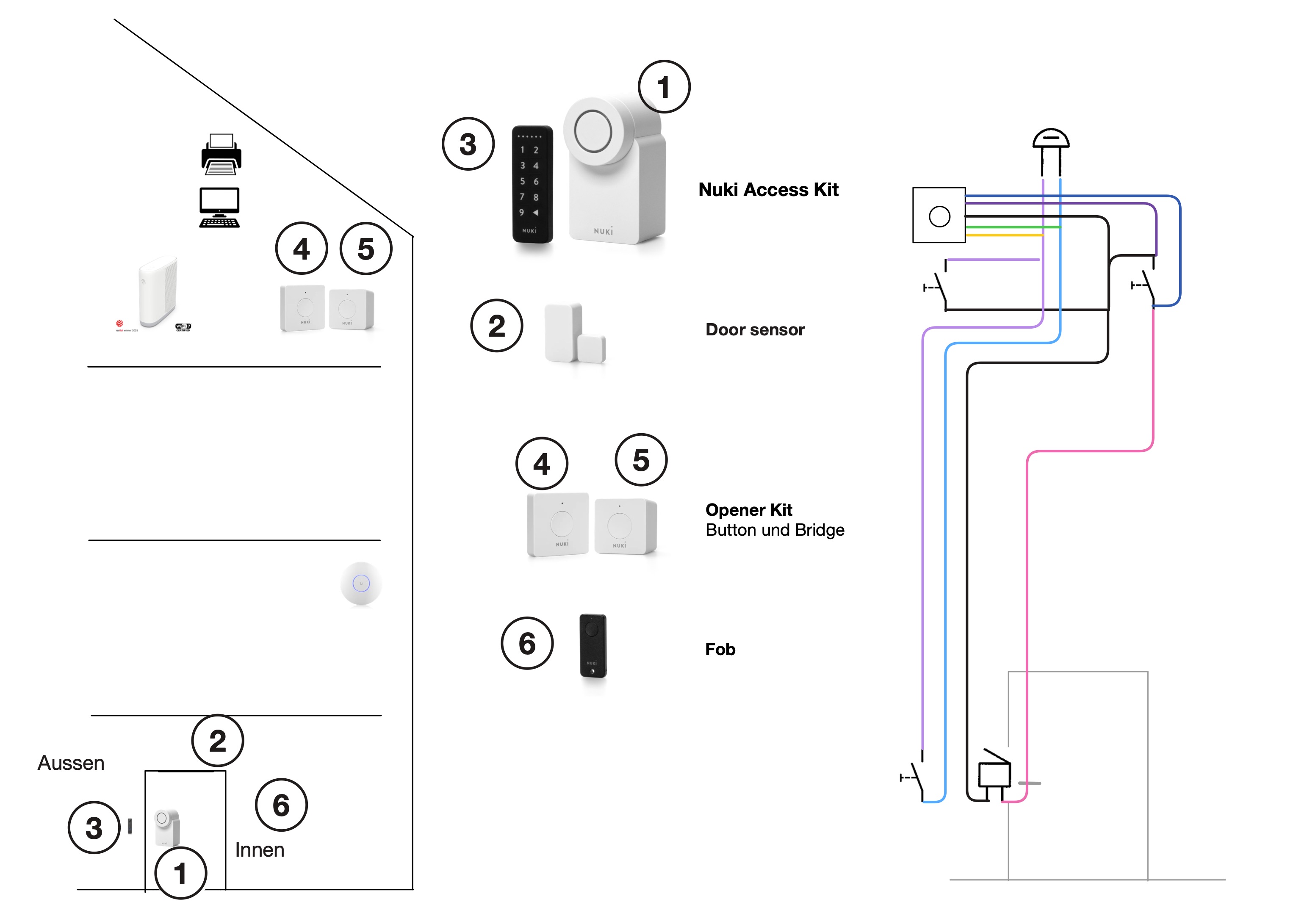

Following the wiring proposal for “Generic Intercom > Analogue” I managed to get things working (buzzer opens, floor bell detected) except the door bell button at the main entrance :grimacing:
In my desperation I even tried to connect bell detection in parallel (as pictured)
Maybe the issue is connected to the missing wiring between floor and main entrance…
My three wiring attempts of Opener Yellow/Green so far:
  1. between Violett of bell > Floor Bell detected
  2. between Blue of bell > Nothing detected
  3. parallel to Violett/Blue > Floor Bell detected
Previous posts either picture a different situation or do not offer a solution for my issue
Thanks for any advice. :people_hugging:

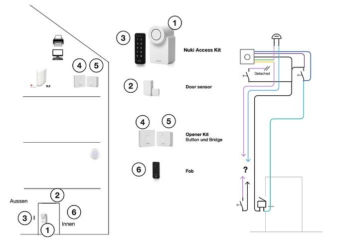

I detached the floor bell button and changed to original version (1), but no success. That’s why I checked the wiring at the main door and surprisingly it’s Violett and Black - not Blue.
