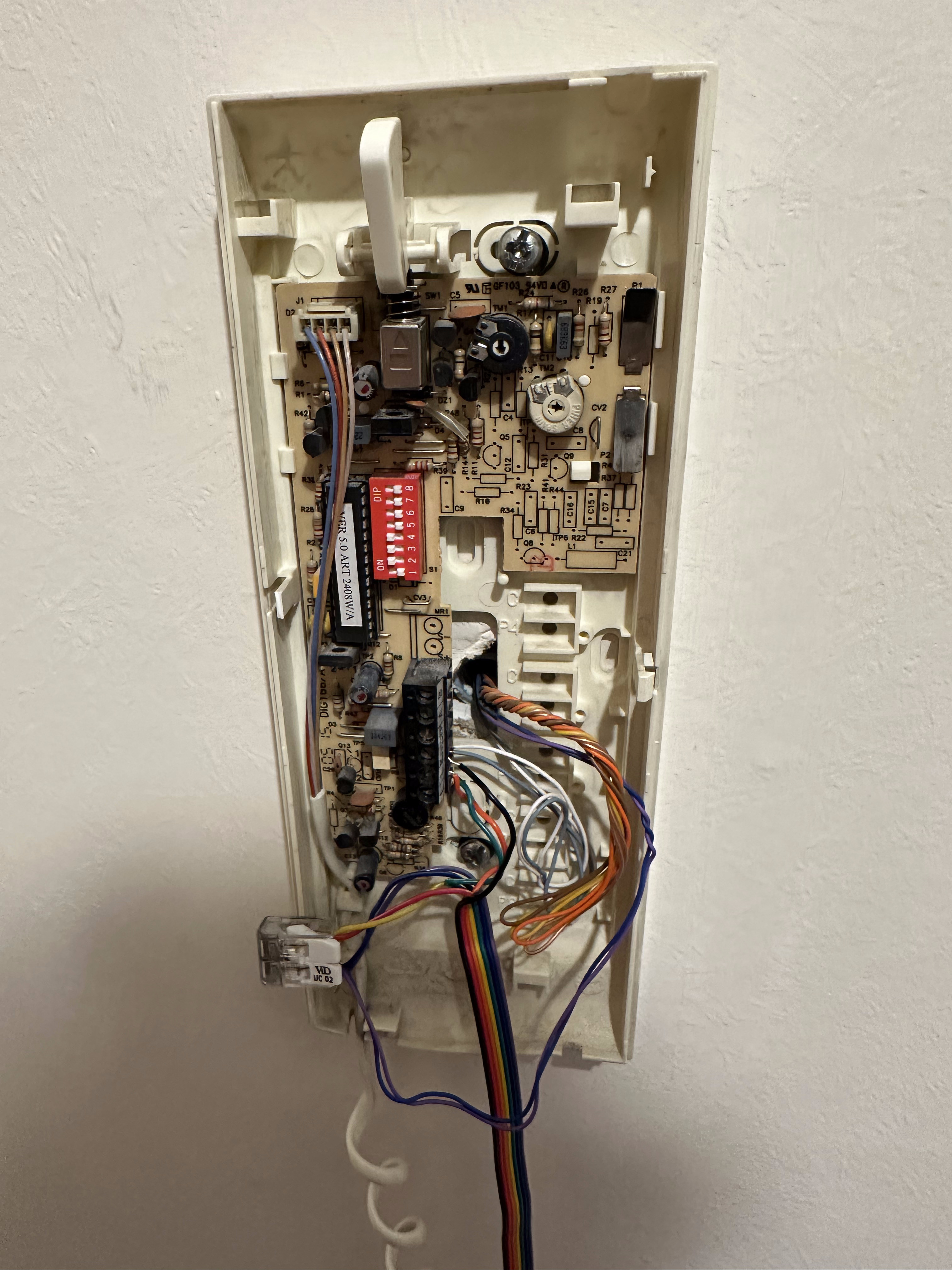

I just have Nuki Smartlock 2 since 1 week, and received Opener today. My building has about 10 years, and my Intercom is a Comelit OKAY 2408W/A.
Before I knew exactly which Intercom I had, I searched on Google. I found a reference which was 2402W, and which is fully compatible with Opener. But Once I opened the Intercom today, I realized that my Intercom is a 2408W and not a 2402W… Same design, same apparence, but inside everything changes…
So my question is : can I use Opener or not? I show you some pictures from inside my Intercom. Every help is precious.
Thank You.
Julien from France.
Pictures :
Cannot add because I’m a new user :frowning:

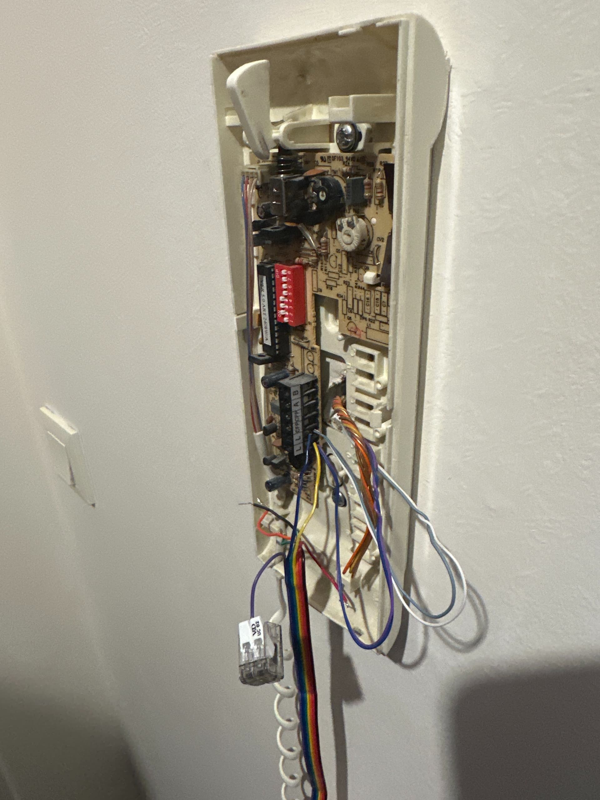

This is inside my intercom
And where the yellow and blue cable goes in is :
L / L / CFP / CFP / A / B
Yellow and blue are in L and L port

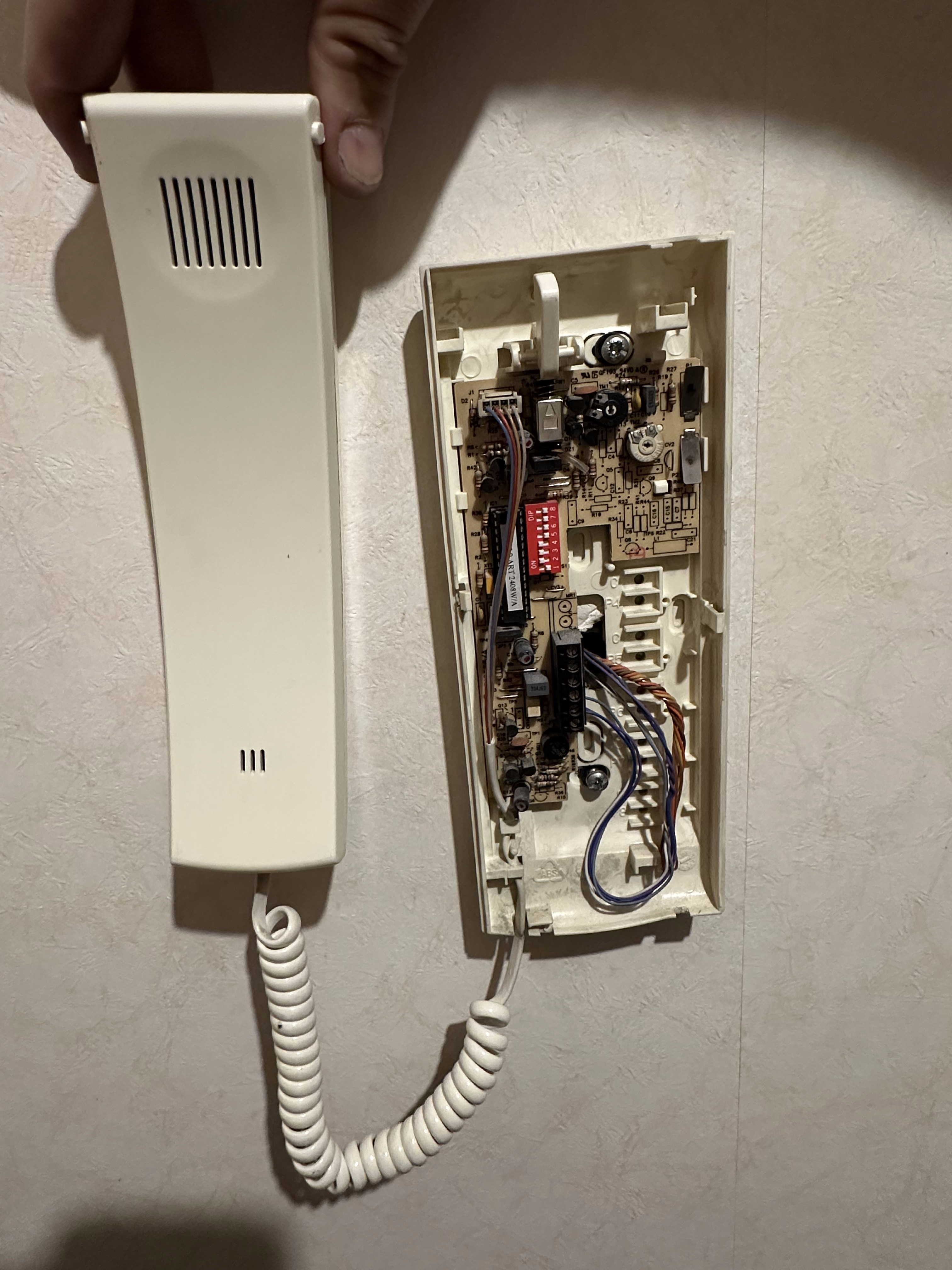

Hi Guys,
I’m not super good in electronic. But I’m really happy you mentionned the name of my Comelit !
I just uploaded the picture.
Please could you confirm me, it’s gonna work for me too ?
It’s COMELIT OKAY : VER 5.0 ART2408W/A
Regards !
