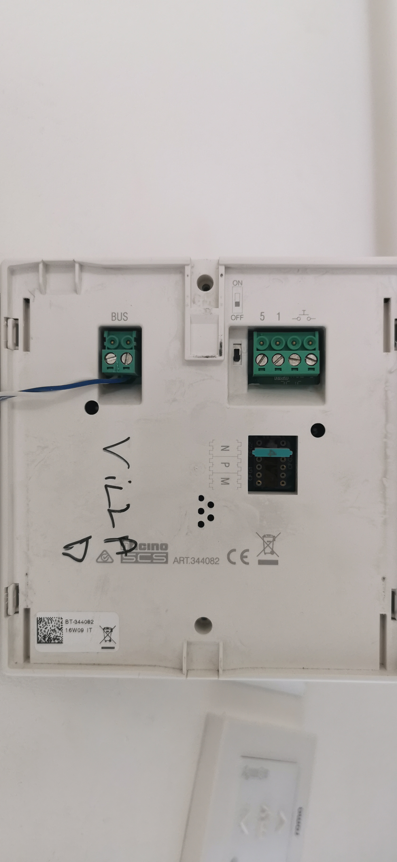

I have a BTicino 344082 with only 2 wire (white and blue).

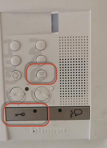

It operates a side door (peoples) and a gate door (car). When pushing the button 6, it opens the car gate and when pushing the key button, it opens the side door.
Normally, as I understand, i need to wire the blue and violet to the BTicino white and blue wires.

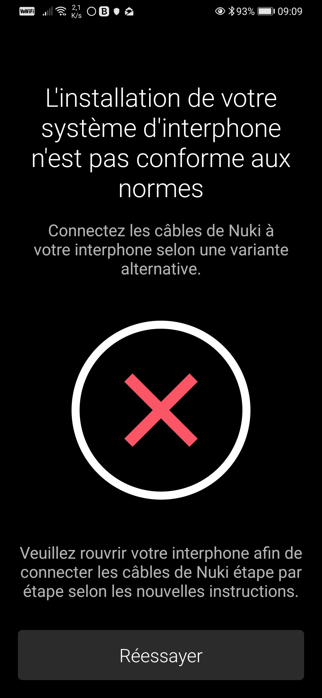

I tried the intercom configuration but at thé end of the configuration process, it tells that there is à wire connection mis match ?
with the door gate configuration it goes without poblem but pushing the nuki button or on app does nothing.
