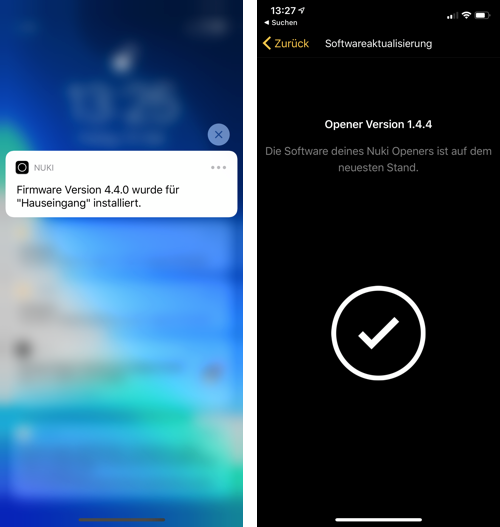

@Juergen The only strange thing is that a notification is showing updated to Firmware 4.4.0.
In the App itself it’s 1.4.4.
With some specific settings (non default) the Opener could have become unresponsive via BLE after a specific sequence of events. Is fixed with 1.4.4.
Thanks for reporting this. Looks like some sort of string formatting bug.
