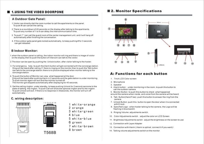

Hi All,
I’m trying to install the Opener on an obscure video door bell. I do not even know if it is a BUS or analogue system. Documentation is scarce however I did manage to get hold of an installation document. Any assistance would be great.
