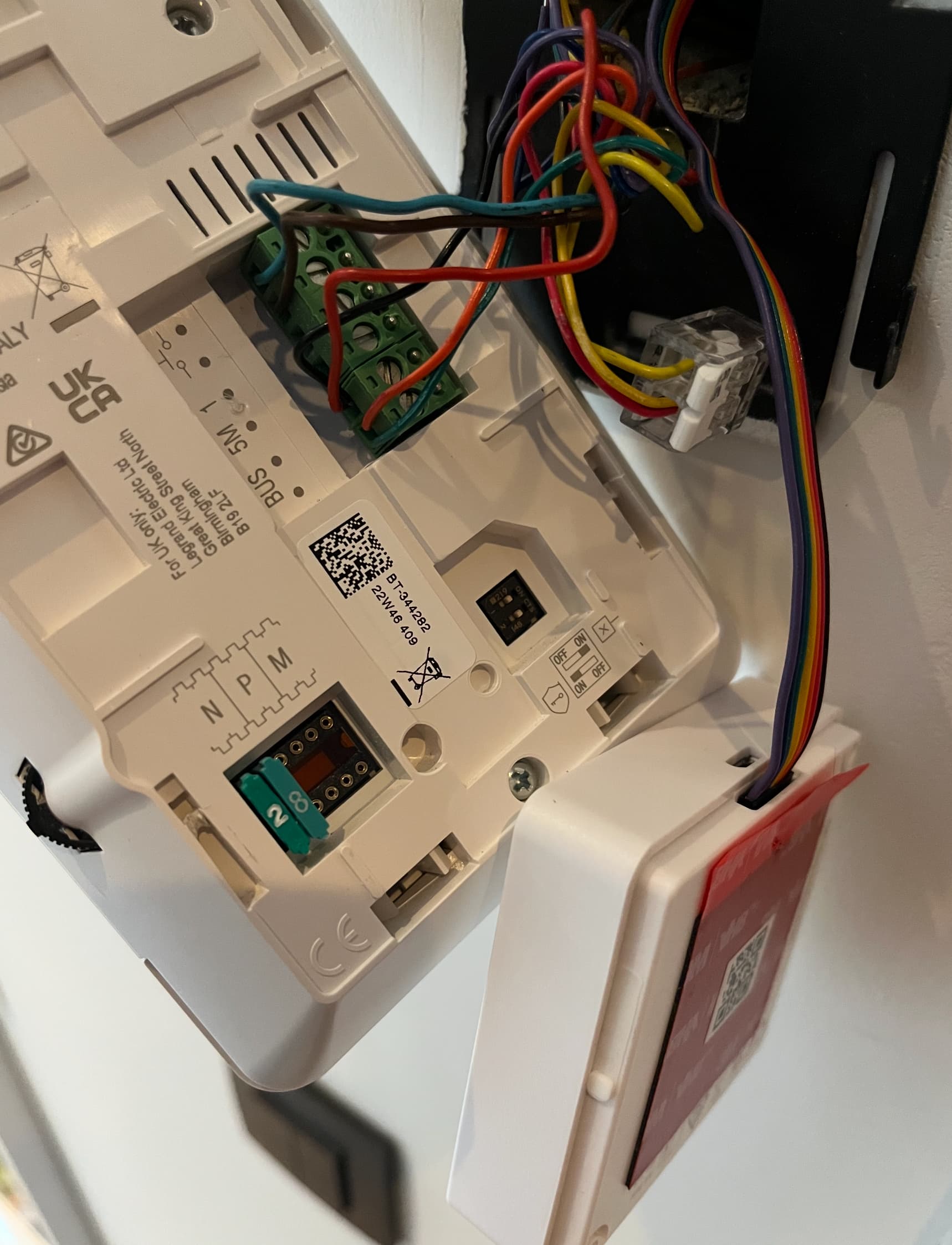

I have tried both Vincent Tissot as well as Maurice montages and none of them worked for me …
Here’s a picture:
Do you guys can help me out? Maybe there’s something I’m missing
Thanks
Hello Benny
Can you send me the same PN please? I’m struggling and need to figure out how to solve it, thank you! :slight_smile:
Do not put two cables on the green connection.
In my case, one of them had no contact. Use another clamp here and only go there with one cable
And then use the Beta Generic to set up for BTicino.
I send you a PN#
