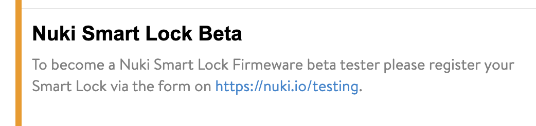

You might already sign up for beta as well. Right after the christmas holidays we will start looking into this and changes usually come in form of beta releases first.

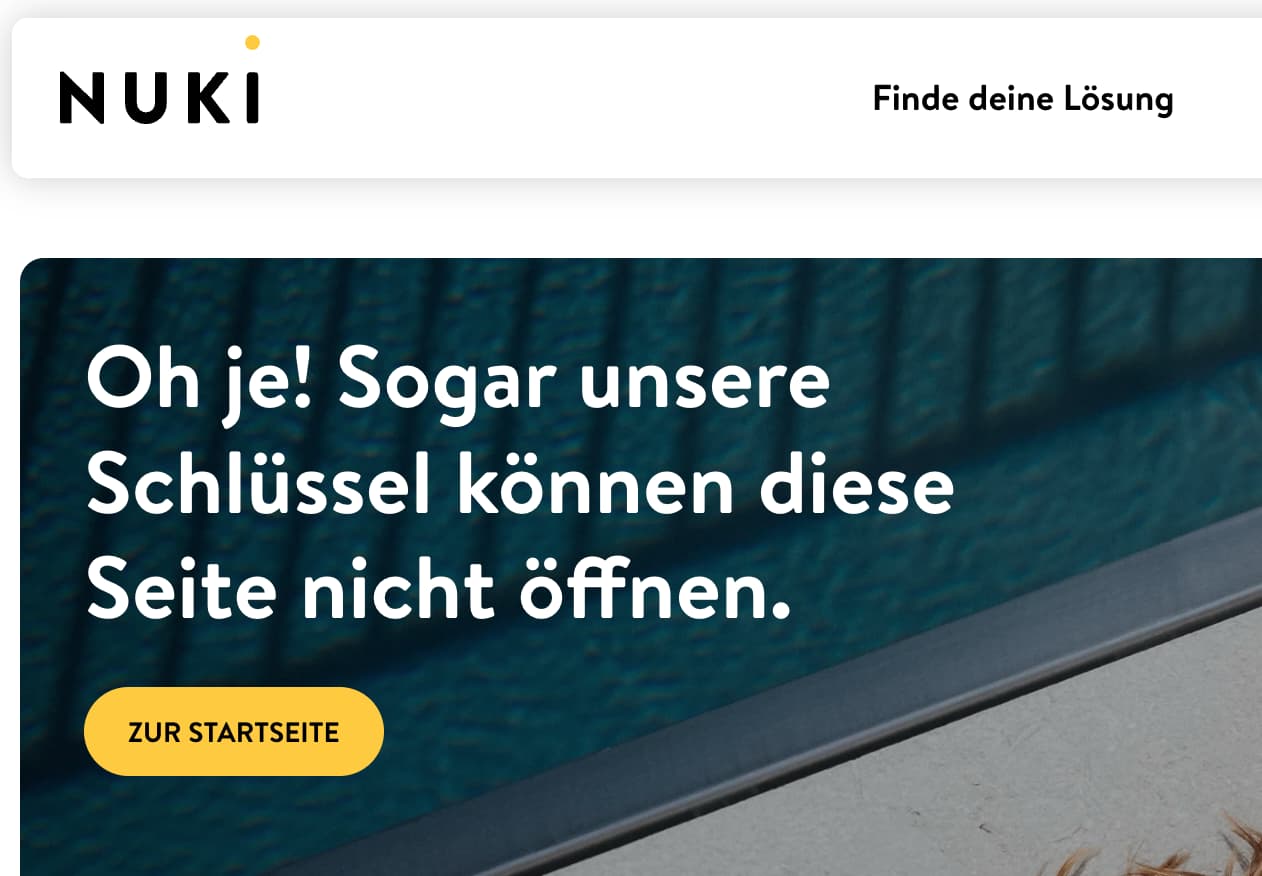

Ok, thanks. But I can’t register under this link:
I only get this:
Oh great … Sorry for that. DM me your Nuki ID please.
