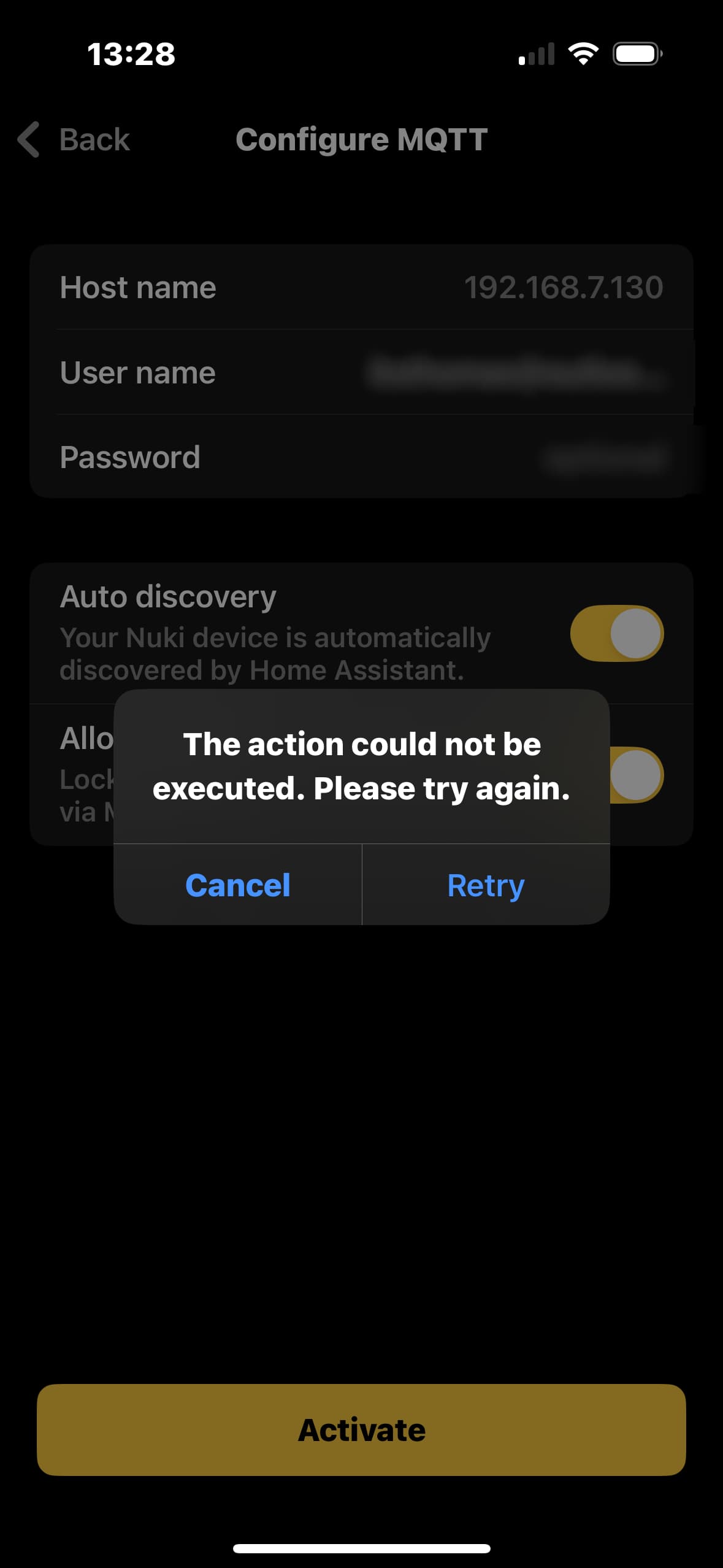

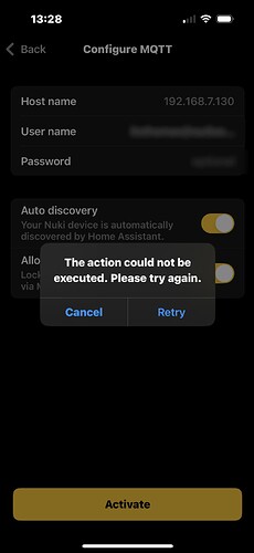

I deleted the MQTT connection in the Nuki app and attempted to set it up again, but it fails with the message: “The action could not be executed.”

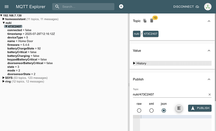

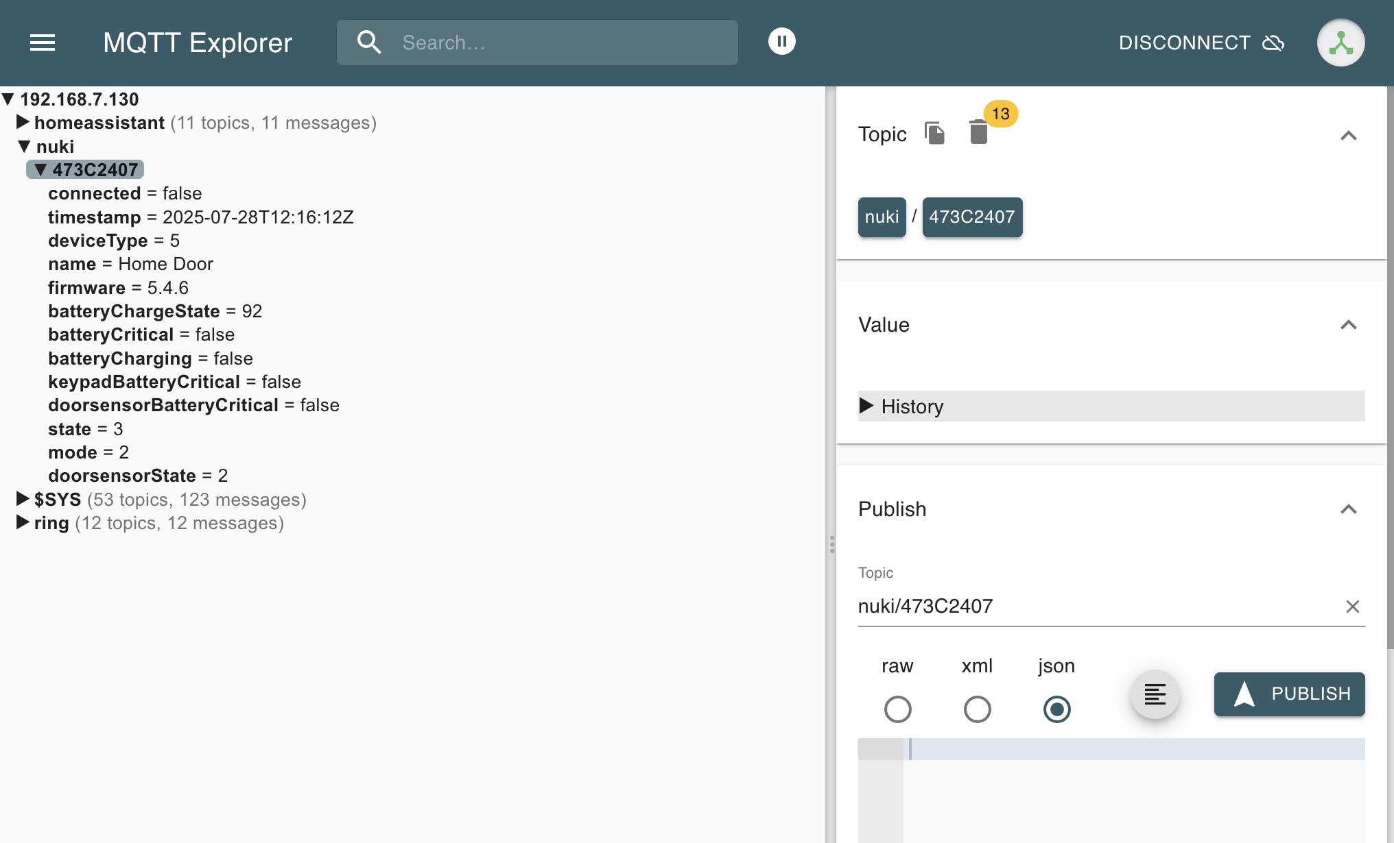

I’m using the Mosquitto broker in Home Assistant. Using MQTT Explorer I am able to connect to MQTT broker and also can see the Nuki, which shows connected = false.
