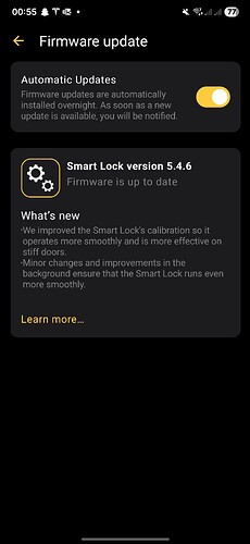

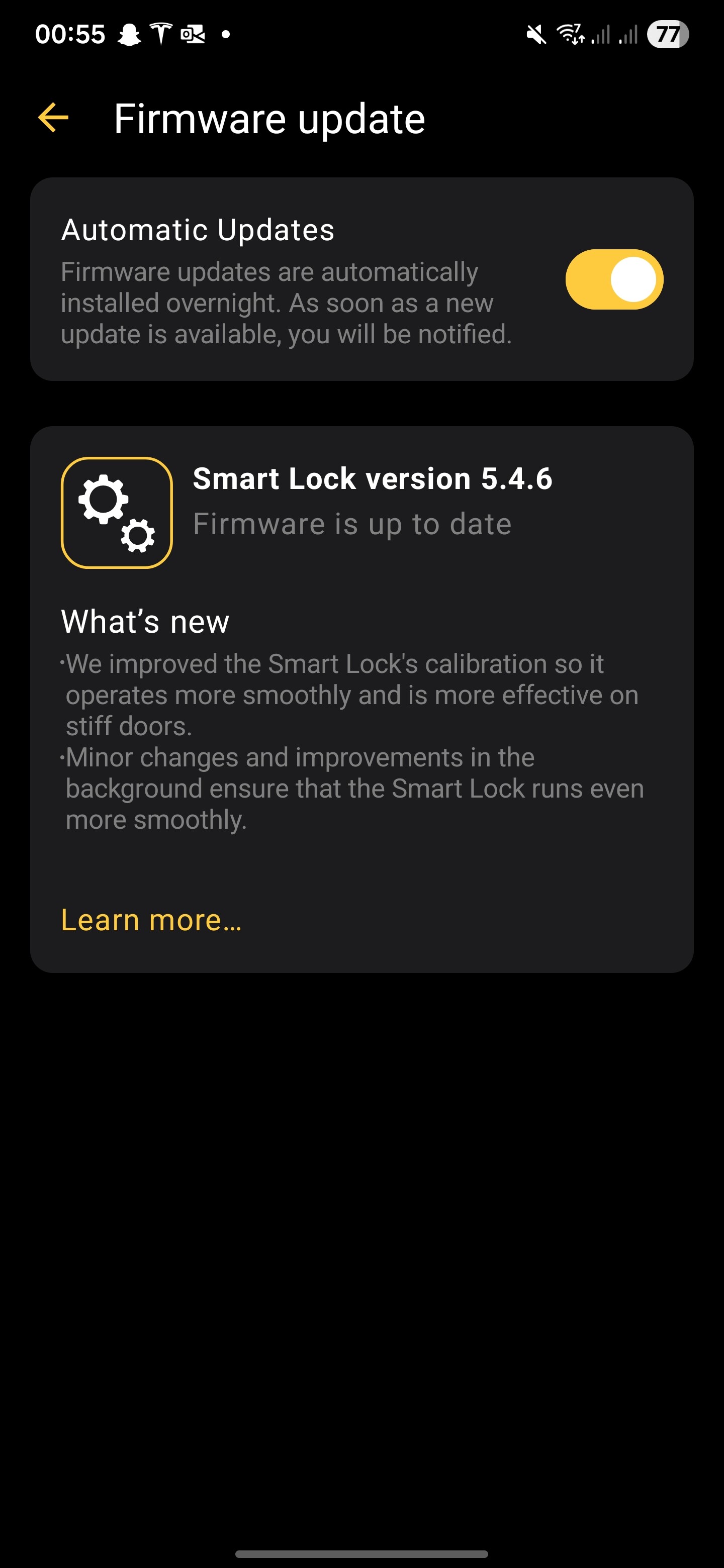

Firmware version of your Ultra?
Hi Andreas
I am on 5.4.6.
