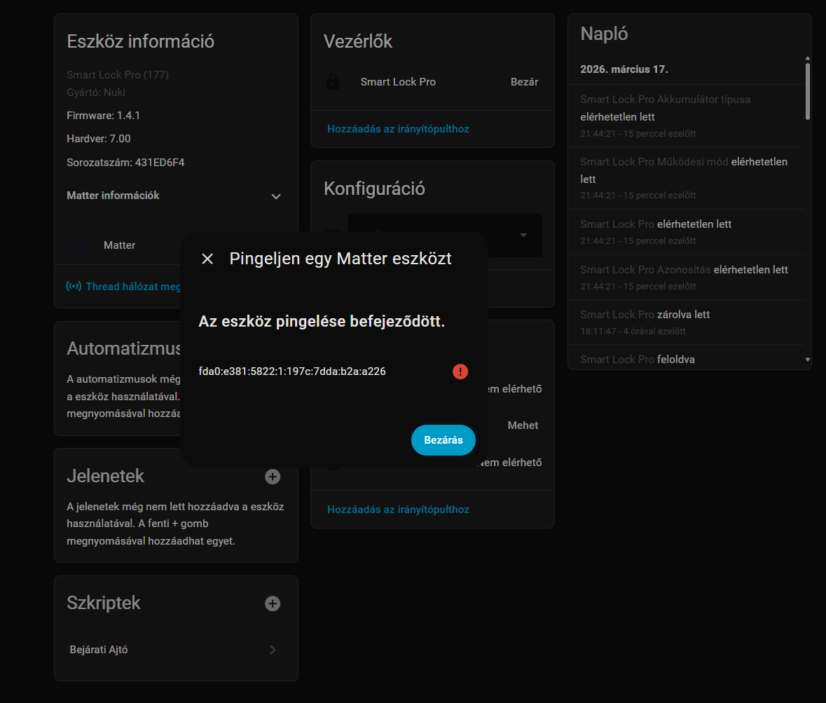

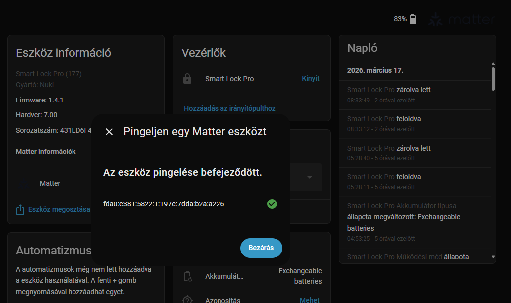

OK AI helped me a little bit with Ping. I found the IPV6 address and I was able to ping from Home Assistant node to Nuki.
First try when its showing unavailabel: Ping does not work dropping error, cannot ping.
After I put out the battery, put it back than trying again:
Thank I got this answer, so looks like the ping also does NOT work when its showing unavailable so yes looks like the thread connectivity is dropped after a few hours in Nuki.
