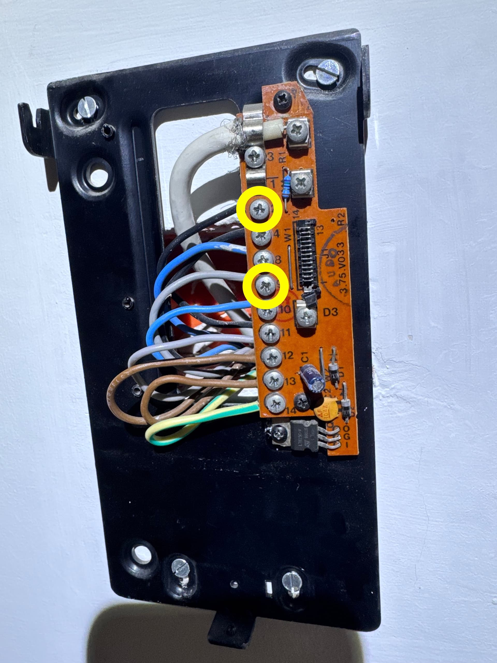

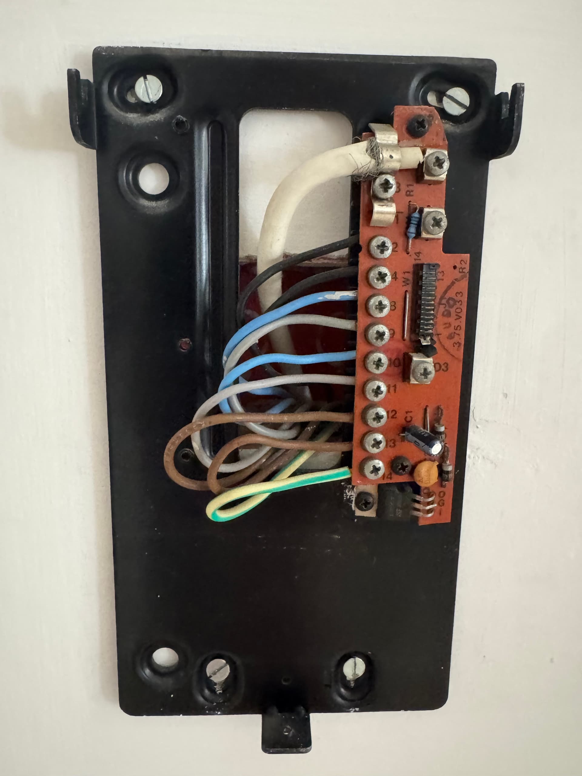

Hello, I bought Nuki opener and bridge and I want to find out how to wire it with my analog video intercom (Farfisa model 1380). I cannot find the cabling diagram nowhere. If possible I only need to find out the opening command and the ground in order to connect it with the corresponding cables of the opener.

I got it to work partially, I can open the door from the app.
:large_blue_circle: Blue cable from the Nuki Opener to the terminal marked with the number 9.
:purple_heart: Violet cable from the Nuki Opener to the terminal marked with the number 2.
