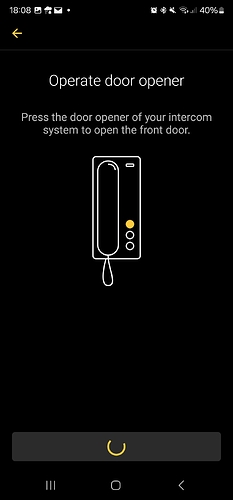

I have tried it with:
Generic analogue - neither of the features works
Urmet 1132 - neither of the features works
Generic Bus - neither of the features works.

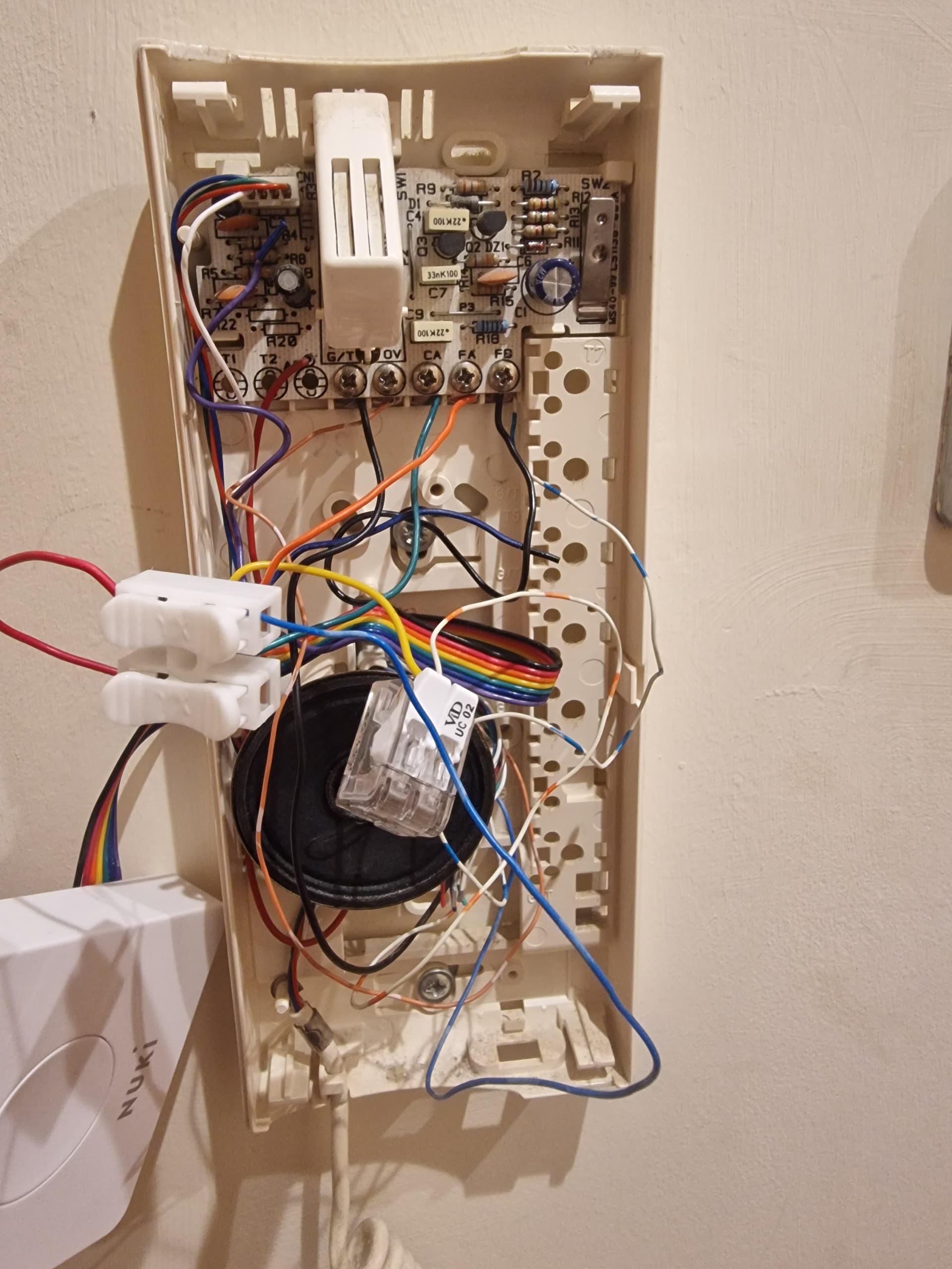

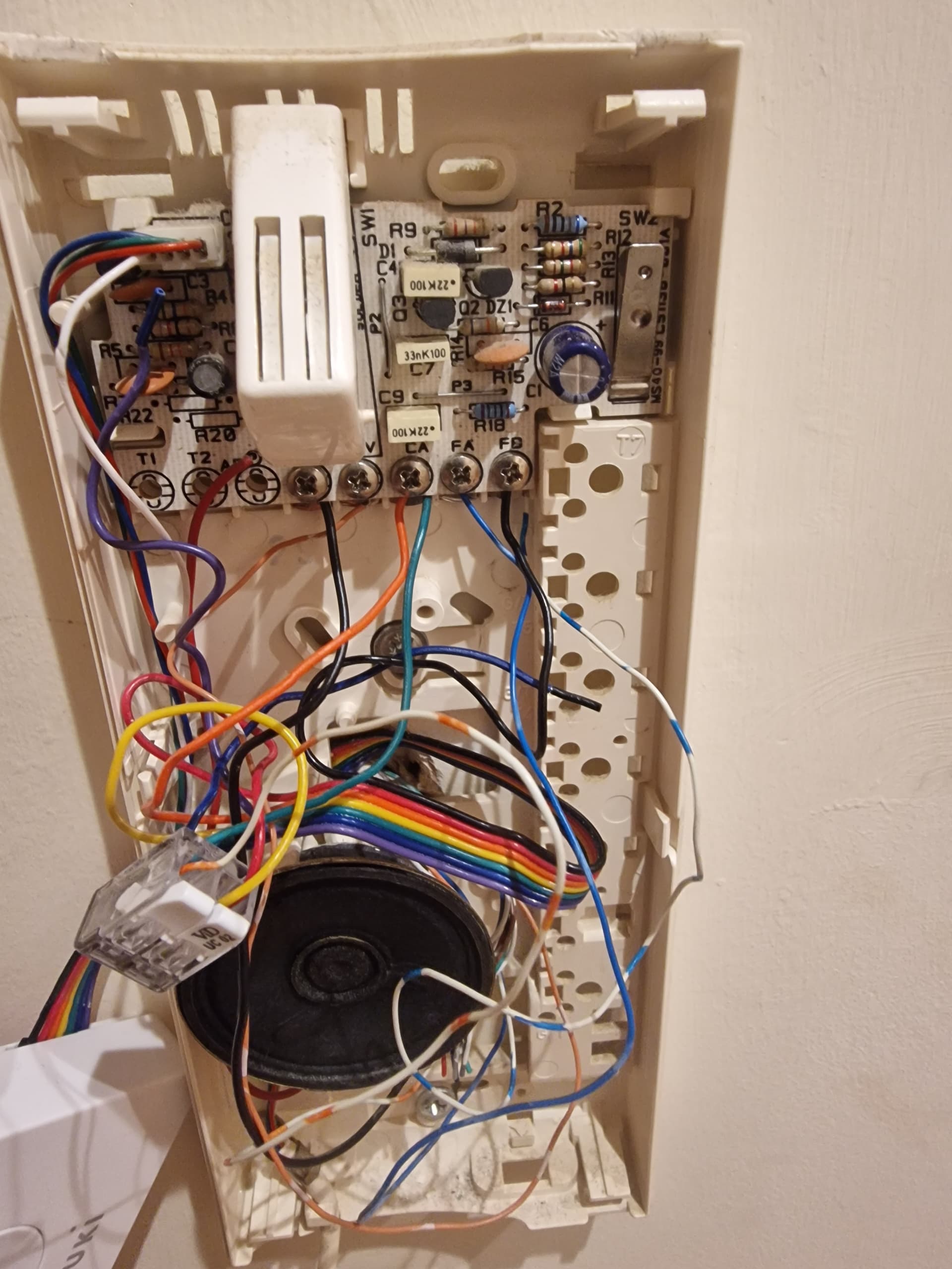

The only clamps I have are a bit bigger (for lighting wires), so not sure they’d fit inside the casing of the intercom. But I can probably obtain a more suitably sized one to get here tomorrow
We can take the bigger ones for trying, if they are not too big, because the signal would not go through good then. As you wish. Here is what to try with a second clamp, - take out the red opener wire of clamp1 and put it in clamp2, now take out the wire what is originally in FA and put it in clamp2, now take out the orange opener wire of CA and put it in FA, finish. Now try a fresh setup.

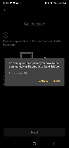

Now we’re stuck at this point again
(Not only is Nuki Bridge connected, but I haven’t left the flat and I’m still within Bluetooth range of Opener!)
Ok, then let’s try again to switch the bus, - take out the wire what was originally in FA of clamp2 and put it back to FA, put also the black opener wire what is in FB now in FA, the orange opener wire what is in FA now put into FB, and the originally wire what is in FB now put in the clamp2, finished. Try again with generic bus.

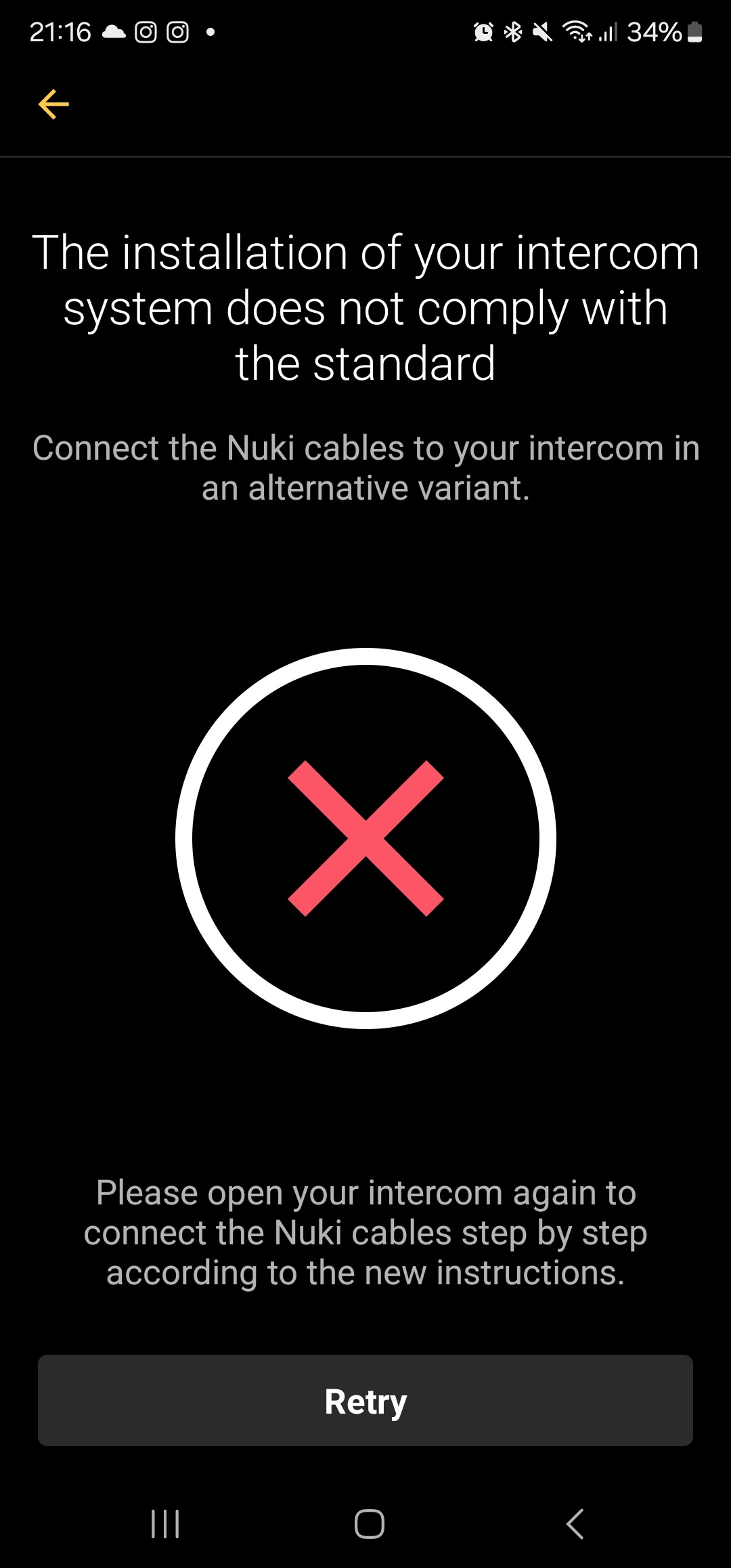

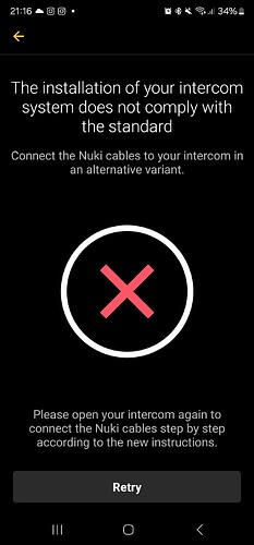

Wiring the bell this way results in an awful high-pitched feedback noise from the intercom, and the following page:
