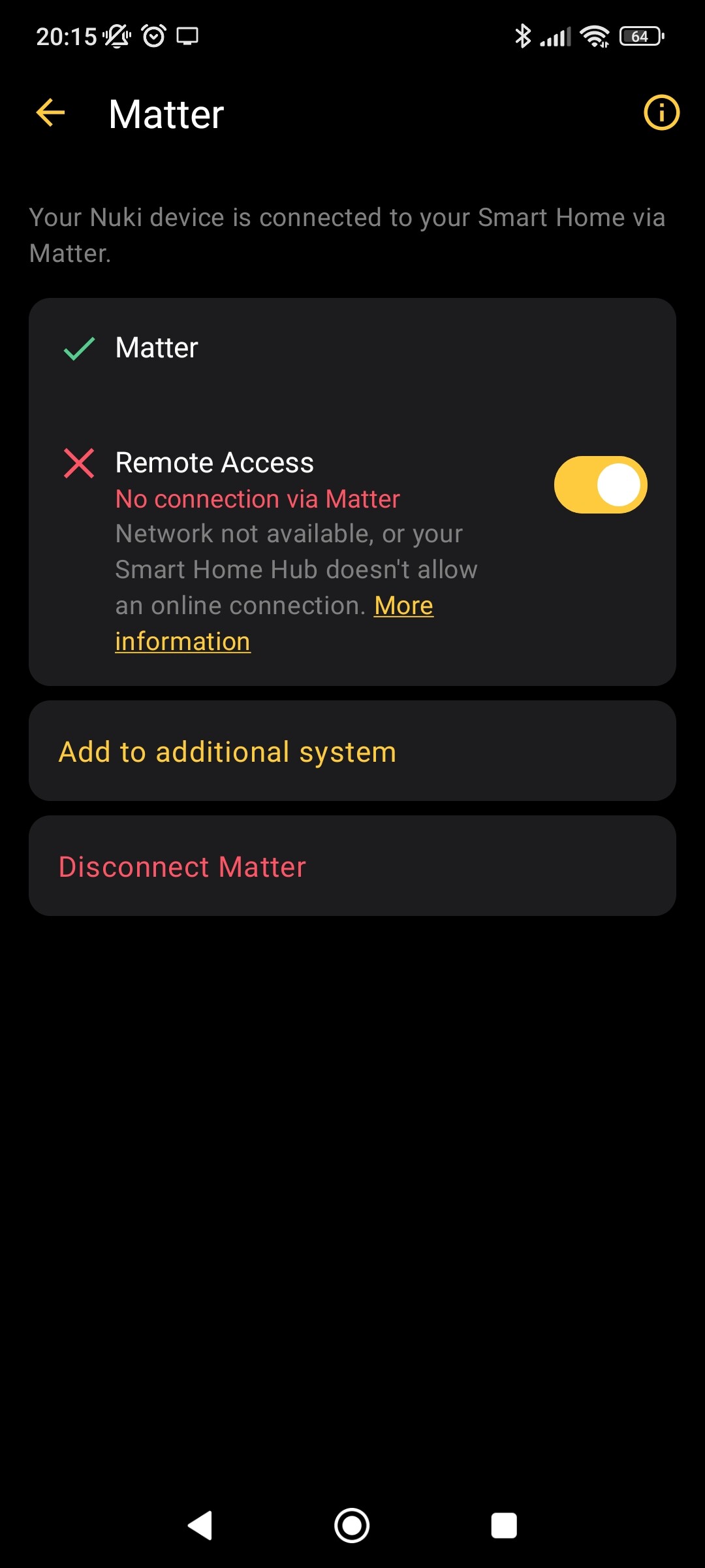

Everything Worked so far. When I opened the nuki app a little while later, The Matter Settings tell me, that Remote Access is enabled, but not working Correctly:

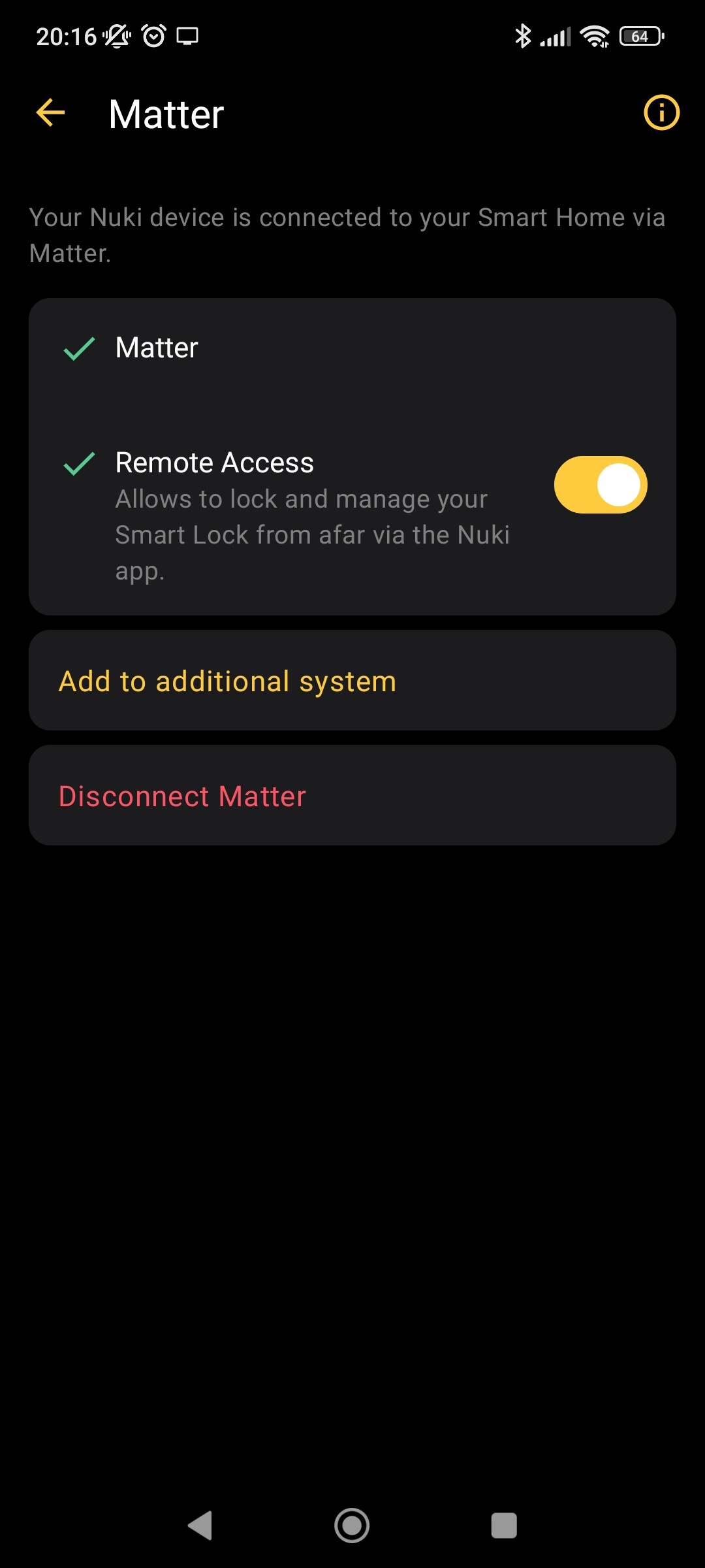

I then tried to disable Remote Access via Toggle and Enable it again, that makes it turn Green and showing the Checkmark:

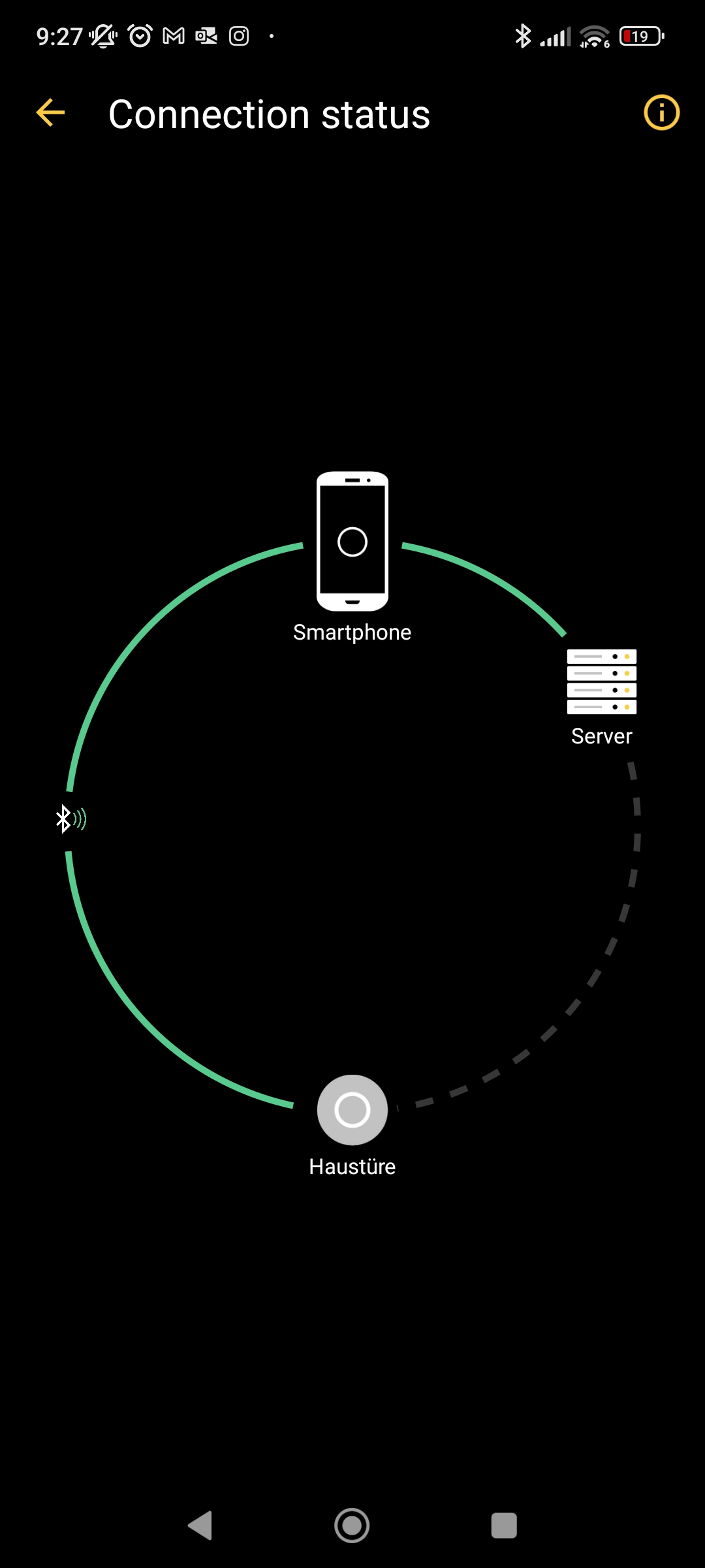

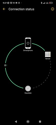

Even though it says, that remote access is working, in the connection status, the matter connection is NOT Shown:
When I leave the app and open it later again, it tells me again, that Remote Access is not Working Correctly.

In my case it turned out, that NAT64 was not activated on the Open Thread Border router. After enabling it and somehow resetting the nuki (instructions from the support see below) and reinstalling Matter Integration and Open Thread Borer router Integration and the Nuki on Homeassistant, it finally works now…
