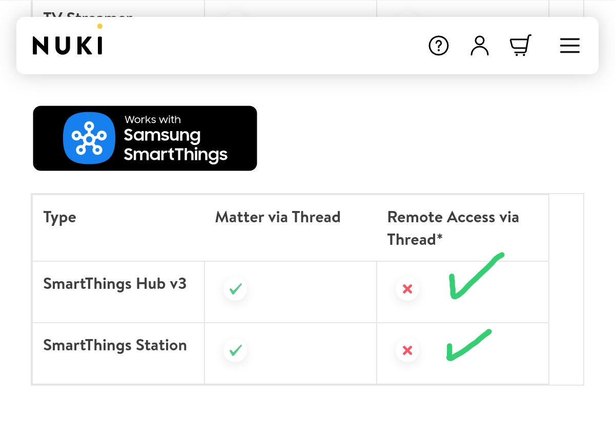

NAT64 support came with the latest firmware update for the SmartThings hubs and it works as expected:
@Juergen : can you please edit this list accordingly?
While at it, add the two Aeotec hubs:
  • Aeotec SmartThings Hub
  • Aeotec SmartThings Hub 2

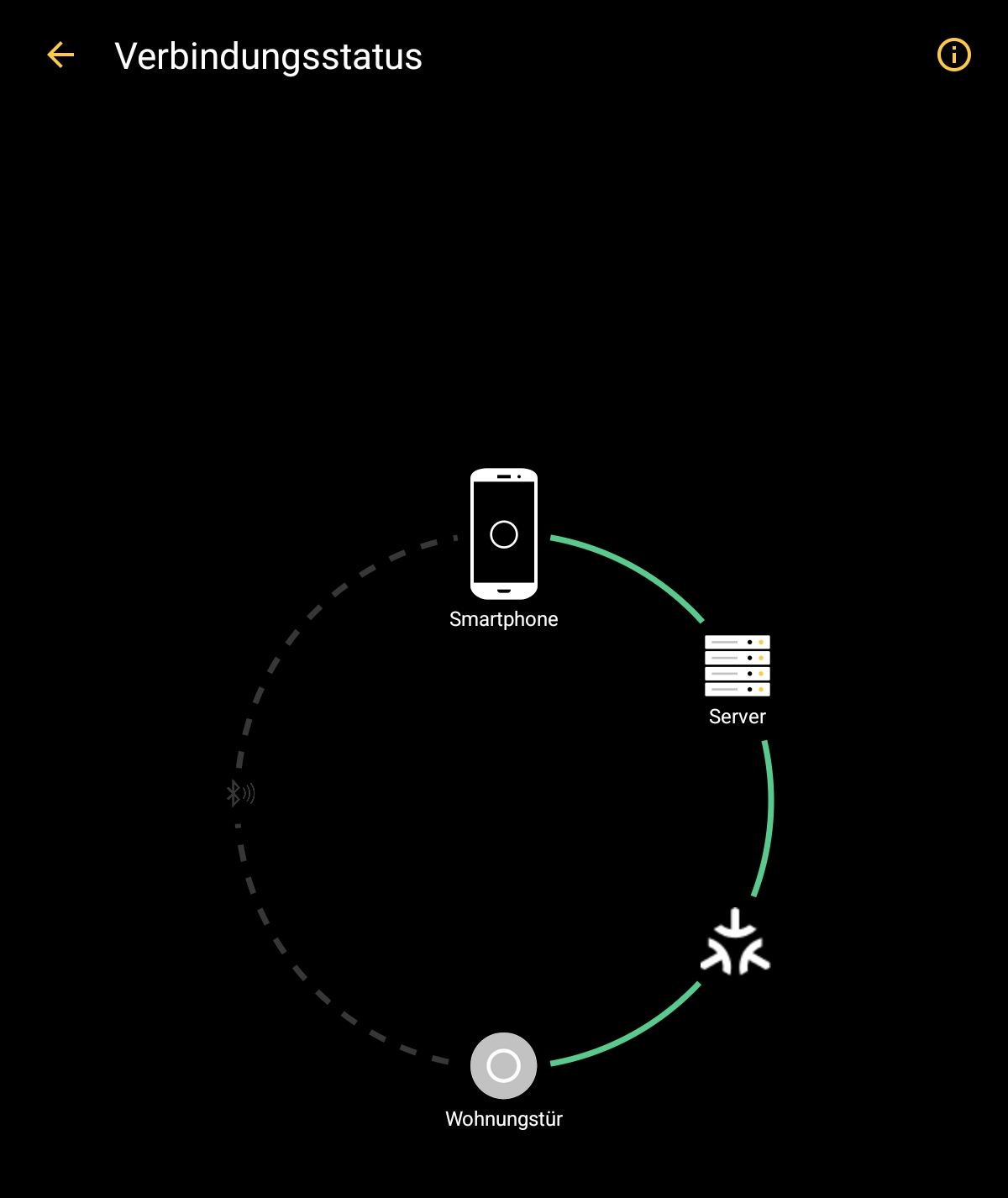

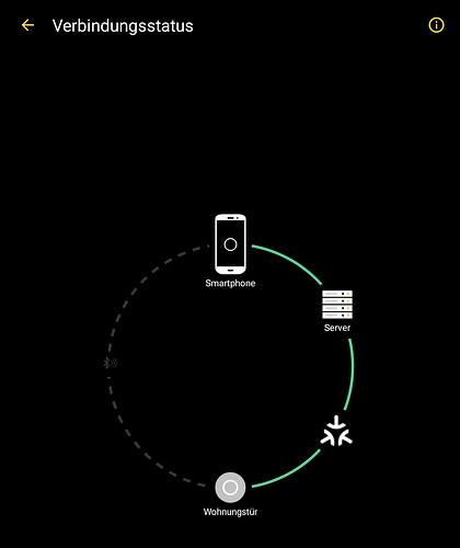

All four dedicated SmartThings hubs support NAT64 now and it’s turned on by default. The Nuki Ultra connected automatically to the cloud after the firmware update without intervention.
