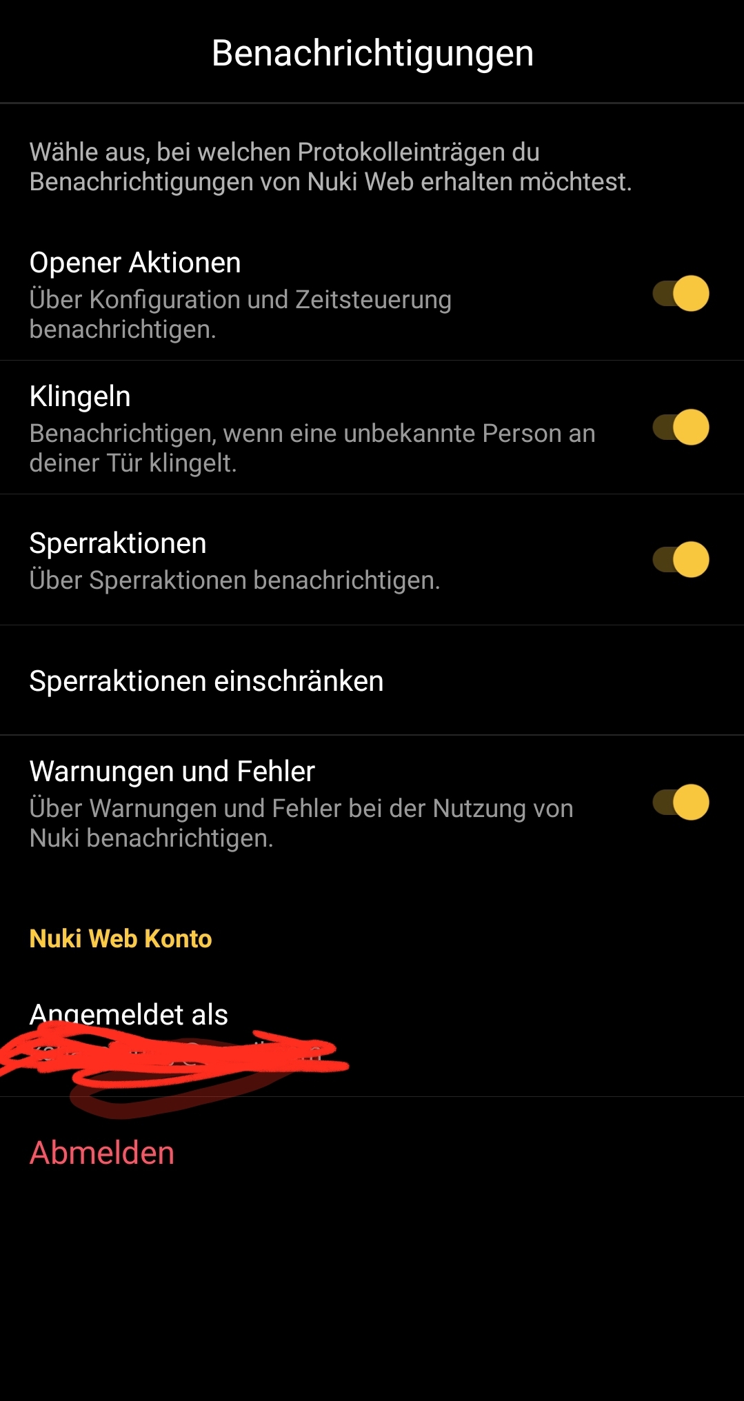

Somehow I didnt get any push notifications to my phone (Android, Samsung S9+), when someone is ringing to the building door.
Settings seems to be correct
