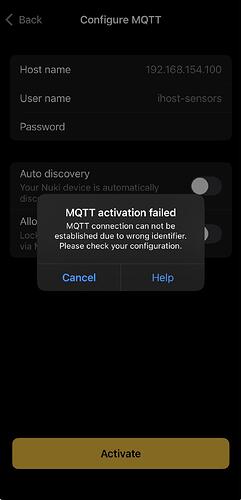

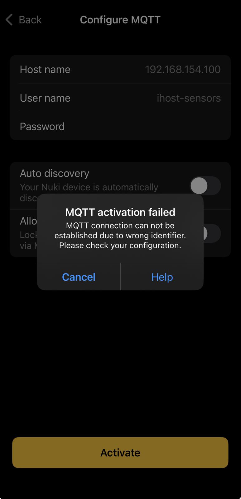

I have been trying to connect my Nuki 4 Pro to an MQTT broker, which is run on iHost machine. Leaving apart an interesting decision to hardcode 1883 port usage, at the end everything ended with “wrong identifier” error, even trying to connect via 1883 port to a fully operational Mosquitto broker, which operates up to v5 protocol and of course supports Client ID as well.

If the app indicates that the MQTT connection cannot be established due to an incorrect identifier, please contact our Support Team.
So I did, I contacted the Support and after 2 days of questioning me whether I tried to switch everything off and on again, whether the lock and the broker are in the same LAN, whether I “checked the identifier”, etc, etc, suddenly they concluded that there is nothing they could help with, they have no idea what that “check the identifier” means in details and they don’t know why the article suggest to contact them, as the issue (quote) unfortunately falls outside the scope of what our Customer Support team can directly assist with.

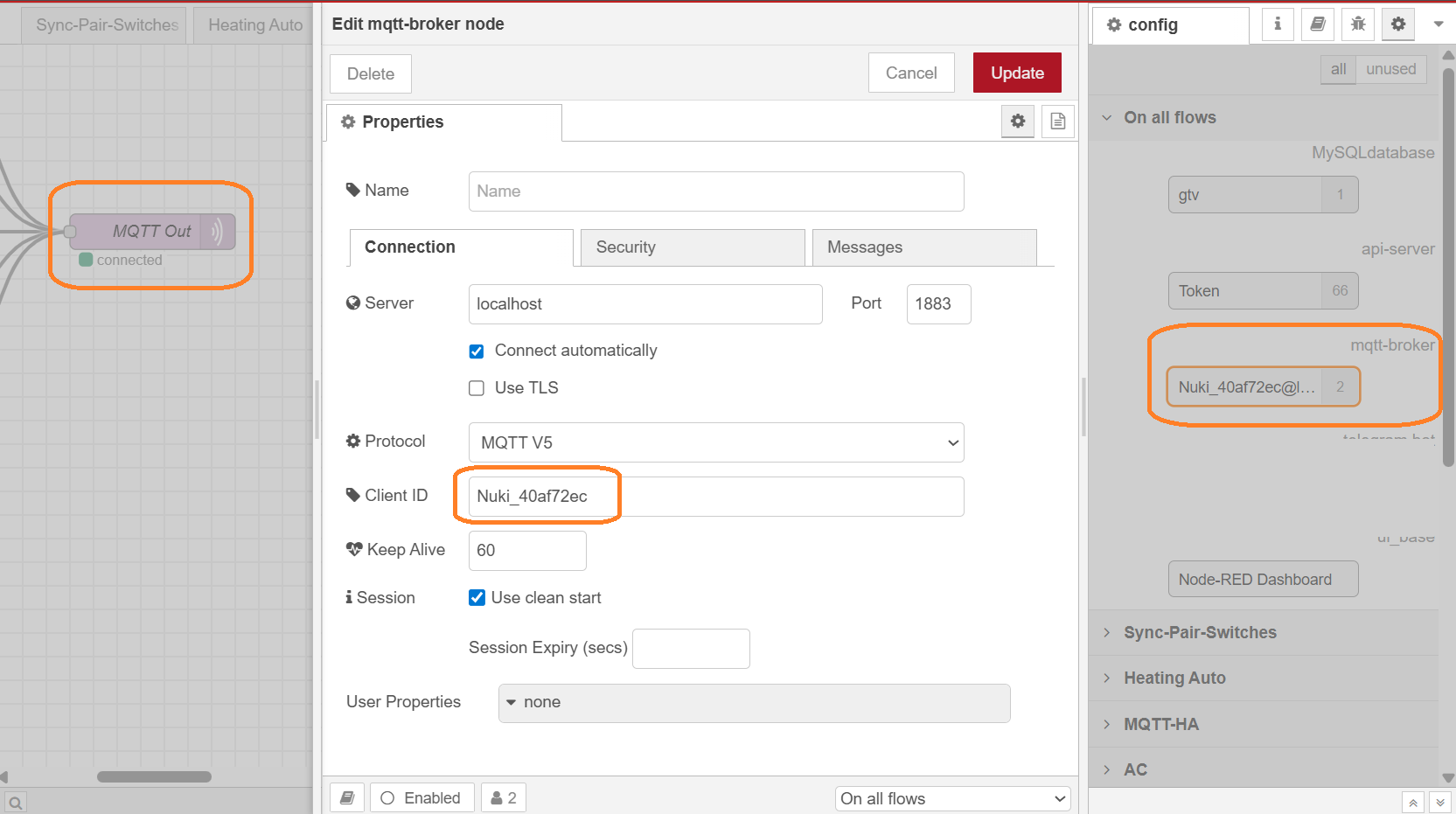

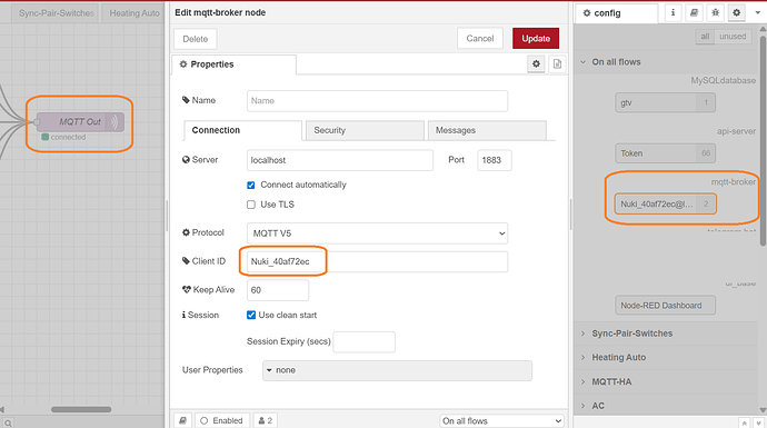

Fact B. iHost built-in Mosquitto broket operates up to v5 protocol and perfectly accepts connections from Client with Nuki_NukiID - please see the attached screenshot below

Taking into account #B - I don’t really think that the problem is really with the Client ID Nuki_40af72ec (same for Nuki_40AF72EC), as all of them are perfectly accepted by the same iHost built-in broker for other connections, from NodeRed, for example.

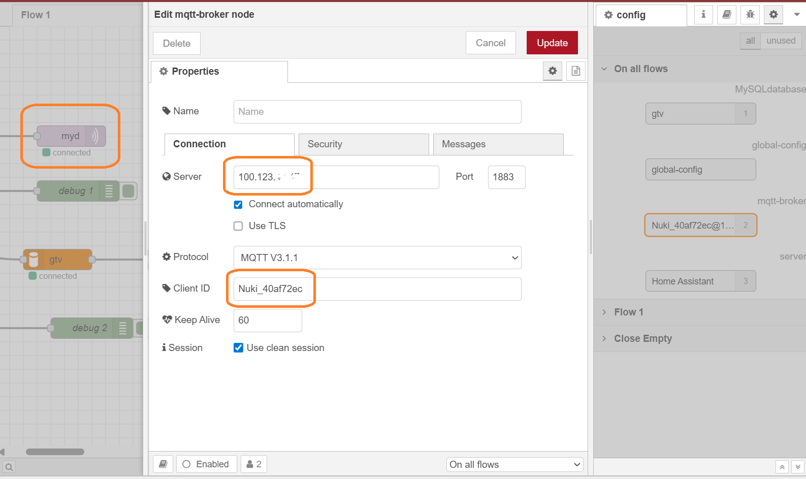

Unfortunately, I can’t go to the apartment where the lock is installed right now, however, I would confirm that the broker there is accepting connections with Nuki_40af72ec clientID even via VPN from here (see the attachment) - and this way more complex route that from same LAN device.
