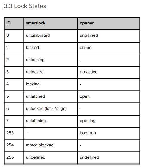

Hi Christian,
State 7 is “Unlatching” not “Fingerprint”.
For a definition of all the states please refer to our MQTT API specification.

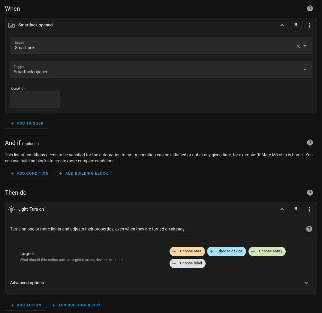

If the “Opened” state is sufficient for you, you may create an automation like this:

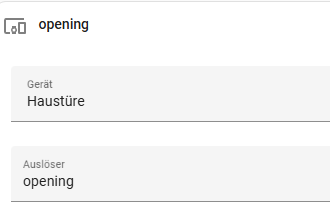

thanks for your help! The “opened” state is not available, only “opening”. But this would be fine for me.
I’ve just wrote the automation and now i’m waiting for the night to test it. Here is the automation in HA:

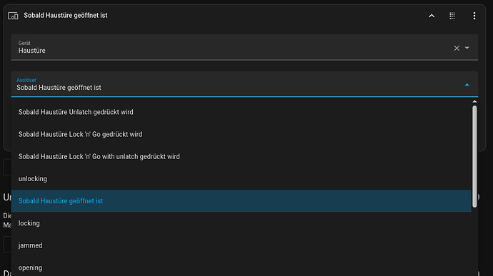

In German it is called “… geöffnet ist”:
