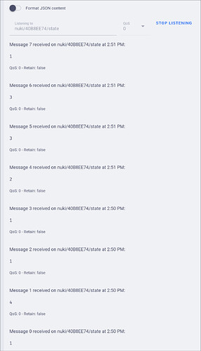

whenever I unlock the door (either through the android app or through MQTT), the correct states are reported but immediatelly followed by a new state = 1 update, telling home assistant that the door is suposedly now locked again
I have physically confirmed that the door is unlocked, and the mobile app shows as such
here’s a screenshot of mqtt events. at 2:50 I locked the door. at 2:51 I unlocked it:

hadn’t though to check that! las entry shows “Unlocked”, while mqtt has two quick 3 → 1 states, ending up as locked

Every time I unlock, the door is physically unlocked, and stays there, but mqtt and the mobile app quickly revert to showing a locked state
