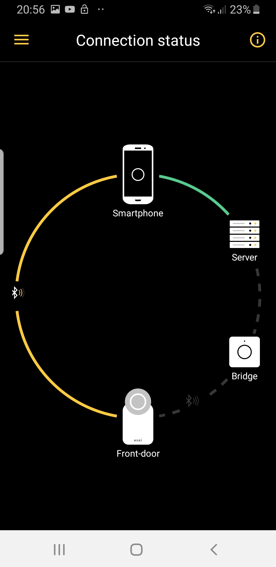

When I check the Connection Status of the Smart Lock, I see a green line between Server and Smartphone, A yellow line between the smart phone and the Smart lock and a dotted line between the Smart-lock and the bridge. Also a dotted line between the Bridge and the server.
I am not sure how to interpret this but I think this also confirms that something is still not correct.
