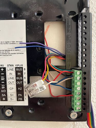

Intermittent Tonality Issue with Nuki Opener on Golmar Tekna V2 Plus (Bus System) – Could a Resistor Help?
Hi everyone,
I’ve completed the setup of my Nuki Opener with the Golmar Tekna V2 Plus intercom (bus-type system) in my apartment complex, using the Nuki Bridge. The wiring appears correct (I’ve attached pre-Nuki and post-setup wiring photos), but I’m experiencing some instability with the system’s functionality.
Firmware version : 1.10.1
Issue:
-80% of the time, when a user presses the button at the main entrance, everything works fine: the tonality is normal, a call is made to the intercom, and the door opens.
-The other 20% of the time, the tonality is very quick, and while the Nuki Opener seems to receive a signal, the intercom does not seem to enter the correct state to open the door.
Questions:
  1. I’m considering placing an 82 Ohm, 0.5W resistor on the + line to see if it might improve the system’s stability. Has anyone encountered similar issues with tonality or responsiveness, and would adding a resistor help stabilize the signal in this type of bus system?
  2. Could someone guide me on how to use a multimeter to diagnose the issue? Specifically, what voltage values should I be expecting pre- and post-resistor on the + and - lines? Also, what are the acceptable voltage ranges that the Nuki Opener can support?
I’ve attached photos of my wiring setup (pre and post Nuki Opener installation) for reference. Any guidance or suggestions would be greatly appreciated! (cc @Georg_S)
Golmar Tekna V2 Plus works!
Hey Everybody,
I just wanted to leave a small comment here with a guide on how to setup the opener with a v2 plus.
  • Use the Bus (Generic) and NOT Bus (Golmar Plus)
  • Follow the wiring as indicated in the app
    • If you have a twisted pair slotted into B+, only the intercom wire is required to be connected to the clamp. The other wire can be left alone.
