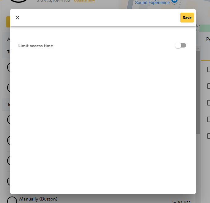

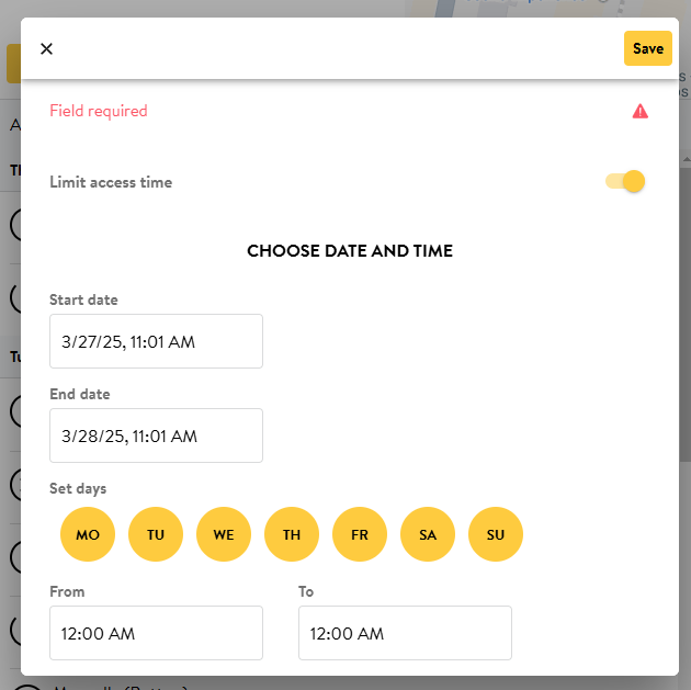

Also, in the portal, if I try to add a new user or create a new entry code, this is the form that appears:
As you can see, a lot of important fields are missing such as name and email for users, and name and code for kepyad entry. After trying to save, an error with message "Field required " appears. Inspecting the page I could not find the missing fields.

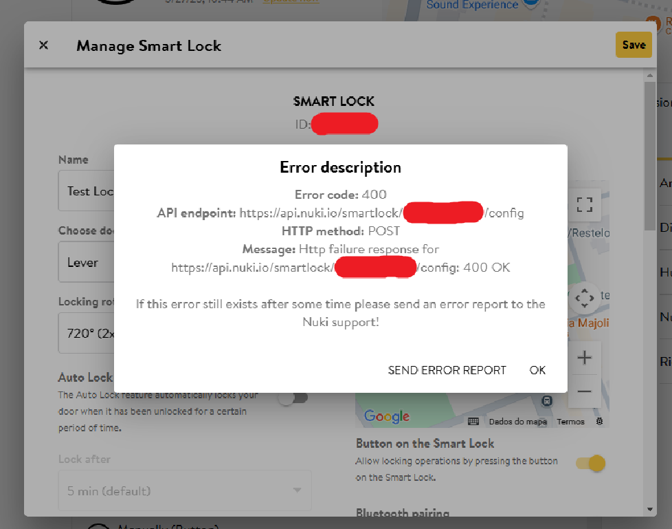

Also, from manage device, everytime I try changing a configuration, I get this message:
Are there any plans to finish the web portal? Because it looks rather unfinished
