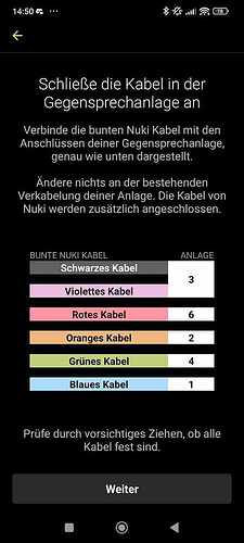

I’ve been able to config a Fermax VEO ref. 3431 following the instructions of the Fermax ref. 3399. The ring cable is the one in position 4, just in case. Follow the app instructions for the rest of cables configuration.

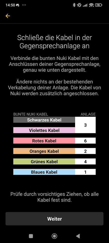

This image is also valid to config Fermax VEO 3441:
