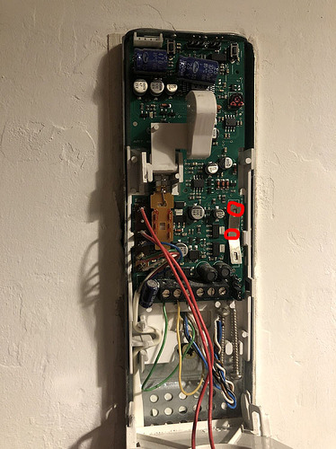

I was now able to connect the 8879 using the “Other Door” configuration as described in https://developer.nuki.io/uploads/short-url/3naDfQDFbzh3Je7ytrNzRDscvFz.pdf
I soldered the purple and blue cable directly to the opener button on the 8879. Good enough for me.

It was a bit of mess to stow the cabel and the connection so I really don’t want to open it again. But it’s totally obvisous the button is the metal thing in the right. See my image attached. I soldered to the back of the plate of course.
Thank u :blush: two last questions : you soldered the wires to the marked red spot (on the back of the plate - this is the only pic I have now) not to the blue spot?
Its still not working :sob: do you have to answer the ring/call before you can open the door? (without nuki opener)
Yes to the back of the curcuit board where the red and blue squares are. You can get the board out quite easily with a screwdriver to access the back.

Meanwhile i solved the Problem according to the Post of Miachael Schiestl! This workes very fine. An disadvantage is, that the functionality “open on ring” can not be conducted, as Nuki doesn’t catch the ring signal. I also had to put out the buttons of the Elvoc device, because after soldering (löten) the wire the base underneath got to high (I am not a very good solder).
Nevertheless it works and looks good after i closed the case of my Elvox.

Hey Everyone! I finally have a solution. For opening the dior i did as described in the post before. For catching the ring signal i connected the yellow and green nuki wires with slot 5 and 6s. thats the external bell (externes läutwerk).
this catches the ring signal and i can enjoy now ring on open and other functionalities!!!
see the picture how i connected it
