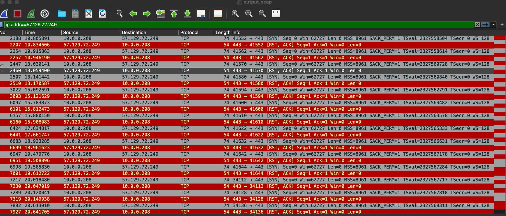

We are having sudden issues to do any request to nuki servers using the API.
Running the same request locally results with 200 OK, while from our servers we are getting "connect ECONNREFUSED 57.129.72.249 443 "
We got even to wireshark to check whats going on, but this is all we can see from our side.

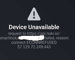

I have the same problem.
I use 2 Nuki locks in Homey and as of today only one works. When I do a reboot, one of them randomly stays non-functional.
What should I do?
